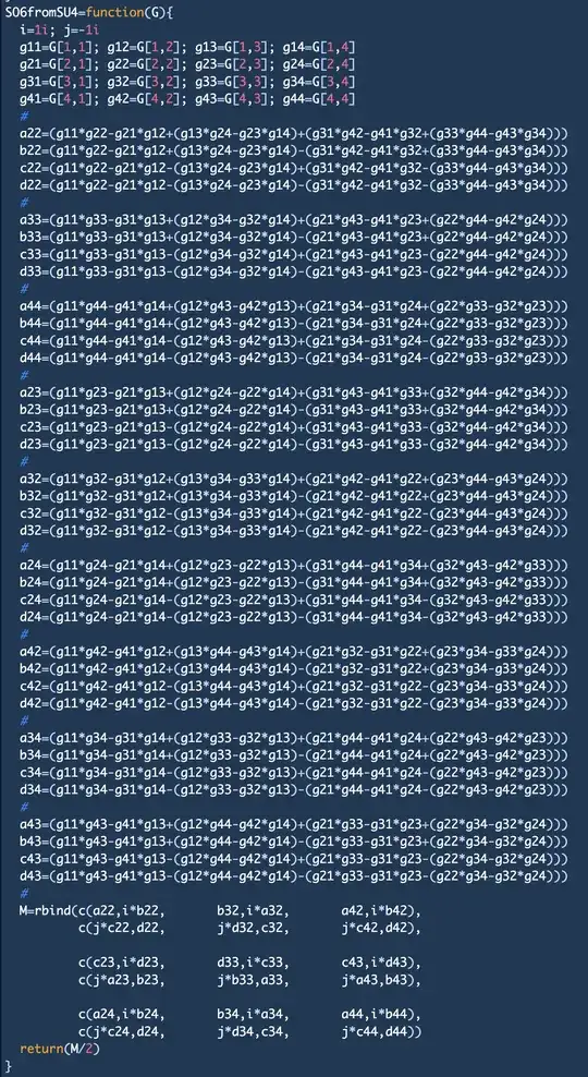

Following the answer of @user10354138 I implemented a concrete map from SU(4) to SO(6) which I tried to write as symmetrically as possible.
