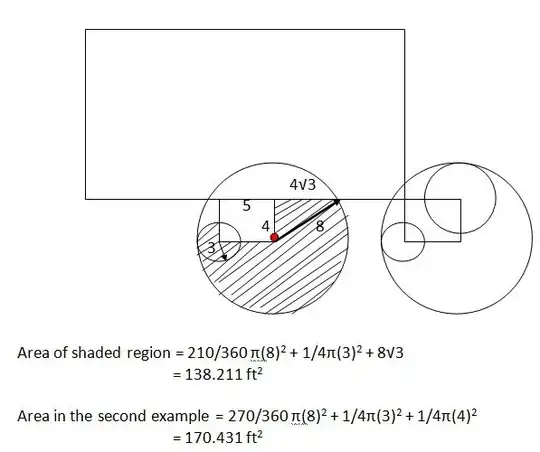

A rectangular shed measuring 4 feet by 5 feet is located along the side of a barn. The barn is 20 feet wide and 45 feet long. A 3 year old goat is tethered to a corner of the shed, not against the barn, with an 8 foot rope. What is the possible amount of space that the goat would have to roam? Express your answer in inequality notation.
Someone help please im so confused. This is word by word. I did research and I found stuff like this but similar, not like this.

    Is there a picture? It seems like the answer would be different depending on exactly how the barn and shed are aligned, and which corner the goat is tethered to. – Jair Taylor Nov 02 '18 at 02:18
    What, I wonder, is the significance of the age of the goat? – Gerry Myerson Nov 02 '18 at 02:23
  • There is no picture – Binzel Nov 02 '18 at 02:38
  • Where did you find this problem? Clearly, us math people have been missing out on the goat-age model of geometry – Sambo Nov 02 '18 at 02:41
  • Sambo, my teacher gave it to me to see if we could do it. 9th grade. – Binzel Nov 02 '18 at 02:54
  • I don’t think this qualifies as a duplicate. The barn, which isn’t in the other question, causes somewhat different geometry and arithmetic. – David K Nov 02 '18 at 03:41
  • I don't think you need a picture for this because we are asked to find an upper bound on the area. I suspect we are supposed to figure out where we are to place the shed. @Binzel I salute you and your classmates. If my 9th grade teacher gave me this problem I would still be there. – John Douma Nov 02 '18 at 04:52
Here are two possible solutions for my chosen configurations.
