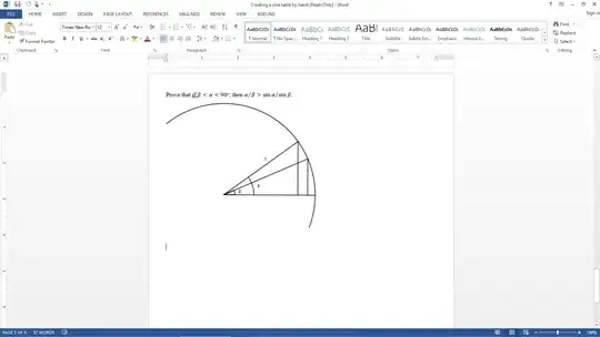

I attempting to prove the show trig identity, i.e. $\frac{\alpha}{\beta} > \frac{\sin\alpha}{\sin\beta}$. I have found that the radius is $1$ so there are three line segments equal to $1$, but I am unsure which segment would be $\frac{\sin\alpha}{\sin\beta}$?
Blue
  • 83,939
K Math
  • 1,265
    Please give more context. Providing context not only assures that this is not simply copied from a homework assignment, but also allows answers to be better directed at where the problem lies and to be within the proper scope. Please avoid "I have no clue" questions. Defining keywords and trying a simpler, similar problem often helps. – robjohn Nov 01 '18 at 15:30
  • @robjohn I have identified the line segments equal to one and a few that are equal to $\sin\alpha$ and $\sin\beta$ (I now see this is difficult to explain without points on my diagram). My question is how to get the two sin over each other? I'm aware that tan is sin/cos but do not know how to approach sin/sin? Maybe a ratio? – K Math Nov 01 '18 at 15:35
    As mentioned in the post on context I linked above, where this problem came from can be important. This is not a simple problem and the simplest approach I see so far is to use the identity $$\frac{\sin(x)}{x}=\prod_{k=1}^\infty\cos\left(\frac x{2^k}\right)$$ and then notice that $\cos(x)$ is a decreasing function on $\left[0,\frac\pi2\right]$. – robjohn Nov 01 '18 at 15:41
    Also note that the inequality, as stated in the question, cannot be correct since taking the reciprocal of both sides gives $\frac\beta\alpha\lt\frac{\sin(\beta)}{\sin(\alpha)}$. You need the assumption shown in the image that $\beta\lt\alpha$. – robjohn Nov 01 '18 at 15:55

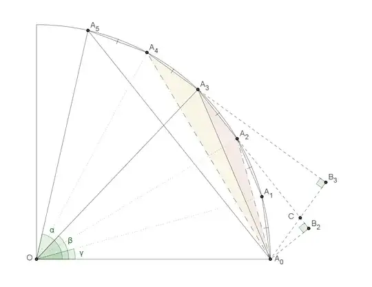

Consider first the case where $\alpha, \beta$ are commensurable, i.e.: $$ \alpha = n\gamma, \ \beta = m\gamma \quad (0 < m < n). $$ By taking a smaller value of $\gamma$, if necessary, we can suppose that $m > 1$.
Inscribe in the unit circle the broken line [polygonal chain] with vertices: $$ A_j = (\cos(j\gamma), \sin(j\gamma)) \quad (0 \leqslant j \leqslant n). $$ Denoting the origin by $O$, we have: \begin{align*} \frac{\alpha}{\beta} = \frac{n}{m} = & \frac{\text{area of polygon } OA_0A_1{\cdots}A_n} {\text{area of polygon } OA_0A_1{\cdots}A_m}, \\ \frac{\sin\alpha}{\sin\beta} = & \frac{\text{area of triangle } OA_0A_n} {\text{area of triangle } OA_0A_m}, \\ \therefore\ \frac{\sin\alpha}{\sin\beta} < \frac{\alpha}{\beta} \iff & \frac{\text{area of triangle } OA_0A_n} {\text{area of triangle } OA_0A_m} < \frac{n}{m} \\ \iff & \frac{\text{area of polygon } A_0A_1{\cdots}A_n} {\text{area of polygon } A_0A_1{\cdots}A_m} > \frac{n}{m}. \end{align*} Define: $$ a_j = \text{area of triangle } A_0A_jA_{j+1} \quad (0 < j < n). $$ Then: $$ \frac{\sin\alpha}{\sin\beta} < \frac{\alpha}{\beta} \iff \frac{a_1 + a_2 + \cdots + a_{n-1}} {a_1 + a_2 + \cdots + a_{m-1}} > \frac{n}{m}. $$It is enough to prove that the sequence $(a_j)$ is strictly increasing, because this implies: \begin{align*} \frac{a_1 + a_2 + \cdots + a_{n-1}} {a_1 + a_2 + \cdots + a_{m-1}} & = 1 + \frac{a_m + a_{m+1} + \cdots + a_{n-1}} {a_1 + a_2 + \cdots + a_{m-1}} \\ & \geqslant 1 + \frac{(n - m)a_m}{(m - 1)a_{m-1}} > 1 + \frac{n - m}{m - 1} = \frac{n - 1}{m - 1} \\ & > \frac{n}{m}. \end{align*} If $B_j$ is the foot of the perpendicular from $A_0$ to $A_{j+1}A_j$ produced, then $A_0B_{j+1}$ intersects $A_jB_j$ at a point $C$, and $A_0B_{j+1} > AC > A_0B_j$, whence $a_{j+1} > a_j$, as required. $\square$
This figure illustrates the case $n = 5$, $m = 3$, $j = 2$:
An illustration of the case n = 5, m = 3, j = 2.
