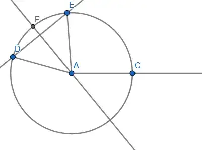

I would like to present you a geometric explanation of what is happening.
If $\xi = \cos x$ and $\eta=\sin x$, then you rewrite your equation as: $$ a\xi +b\eta=c,\qquad \xi^2+\eta^2=1. $$
So you are trying to find intersection points of a line and a circle. enter image description here
Simple geometry tells us that bisector $AF$ is perpendicular to line $DE$. If $\angle CAD = \alpha$ and $\angle CAE = \beta$, then $\angle CAF=(\alpha+\beta)/2$. On the other hand, coordinates of $F$ are $$\xi_F = \pm \frac a{\sqrt{a^2+b^2}},\qquad \eta_F=\pm \frac b{\sqrt{a^2+b^2}}$$
because vector $(a,b)$ is normal to line $a\xi +b\eta=c$, and then we scale it so $F$ lies on a unit circle. We also have $\pm$ here, because bisector intersects circle in two points, and which of them is $F$ depends on the value of $c$.
$$\cos(\alpha+\beta)=\cos\left(2\frac{\alpha+\beta}2\right) = \cos^2\frac{\alpha+\beta}2 - \sin^2\frac{\alpha+\beta}2 = \xi_F^2 -\eta_F^2=\frac{a^2-b^2}{a^2+b^2}.$$
Notably, our answer doesn't depend on the choice of the signs, as $(\pm a)^2 = a^2$
Vasily Mitch
