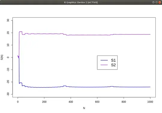

So, considering this question is not likely to be answered, I'll just offer some illustrative numerical results:
$$S_1=\sum_{n=1}^N \frac{\tan(n)}{n^3} \\ S_2=\sum_{n=1}^N \frac{\sin(n) \tan(n)}{n^3}$$
The same constant values are preserved at least up to $N=10^5$, though I haven't checked further.

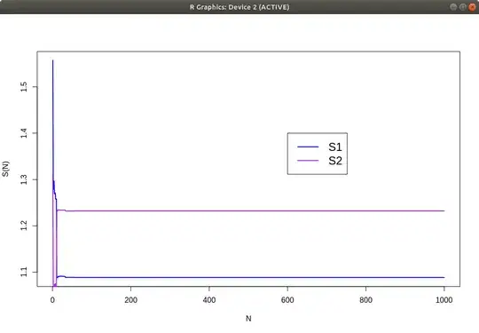

It's useful to also check:
$$S_1=\sum_{n=1}^N \frac{\tan(n)}{n^2} \\ S_2=\sum_{n=1}^N \frac{\sin(n) \tan(n)}{n^2}$$

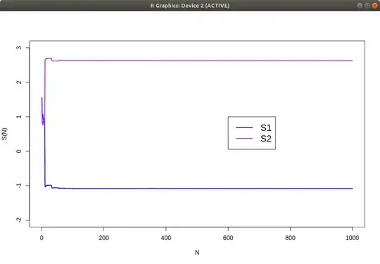

and:
$$S_1=\sum_{n=1}^N \frac{\tan(n)}{n} \\ S_2=\sum_{n=1}^N \frac{\sin(n) \tan(n)}{n}$$
We see some problems with convergence for $1/n$, as expected.
Again, this is just an illustration, definitely not an answer.
