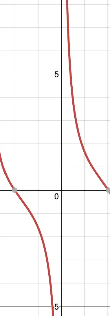

Note that the limit $\lim_{x \to 0} (\frac{2\cos{x}-x\sin{x}}{x\cos{x}+\sin{x}})$ does not exist.
In fact, even before that $\lim_{x \to 0} (\frac{\sin{x}+x\cos{x}}{x\sin{x}})$ does not exist as well.
This is the graph of $\frac{\sin{x}+x\cos{x}}{x\sin{x}}$.
