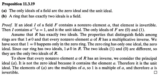

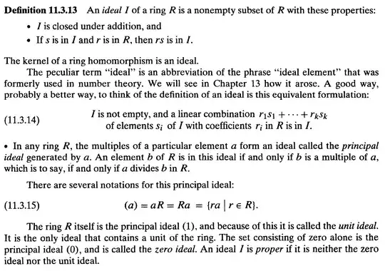

Artin has different definitions of rings particularly that his rings are unital and commutative in both addition and multiplication. Therefore, ideals are neither right nor left, afaik. (*)
In the book, Artin proves that a commutative unital ring with exactly 2 ideals is a field. (*) For non-commutative unital rings, I would like to know what we get under certain circumstances eg a non-commutative field or a division ring. Edit: Apparently, non-commutative field isn't necessarily defined as a division ring or anything at all. What I mean by non-commutative field is that we have all the properties of fields except that multiplication is not commutative.
If a commutative unital ring with exactly 2 ideals is a field, then...

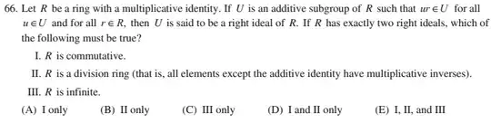

This is based on a GRE question:
I mistakenly answered $D$ instead of $B$ because I forgot that Artin defines rings to be commutative.
It appears the answer to my first question is affirmative because of Ian Coley's solution (which I think forgets to say $r \ne 0$)
I don't see how the answer to my second question would be different because $0$ and $R$ I guess are still left ideals.
Definition of ideals of a ring:
Prop 11.3.19(b) says a ring with exactly 2 ideals is a field:

    Clearly the question’s definition of a ring does not require it to be commutative, otherwise option (I) would be silly to include. And I would think that the solution you posted answers most of your questions. – Joppy Oct 23 '18 at 03:48
  • @Joppy Thanks! I guess the solution answers 1 and 2 in affirmative, but I don't think Artin has left or right ideals at least in Ch11.1-11.3, so I don't immediately know, and it might be tiresome wheel reinventing if I try it out. Does the solution posted, in your opinion, answer questions 3-5 for someone whose knowledge of left and right ideals is currently limited to this GRE question? – BCLC Oct 23 '18 at 03:58
  • It’s unclear how you want this question answered, since you are changing assumptions like commutative and unital throughout your post. A ring with exactly one ideal must be the zero ring, since $0$ and $R$ are always two-sided ideals, which answers 3 and 5. – Joppy Oct 23 '18 at 04:01
  • @Joppy What do you mean? Are left ideals necessarily not right ideals and vice-versa? My questions explicitly say 'non-commutative'. As for unital, does this question assume unital? I guess so based on Ian Coley's solution. Wait you point out yourself here that the ring is unital. Soooo yeah unital non-commutative. – BCLC Oct 23 '18 at 04:40
  • Question 66 starts by saying that the ring has a multiplicative identity. And no, in non-commutative rings, a left ideal may not be a right ideal. For example, consider the ring of 2x2 matrices over some field, then the matrices with zeros in the right column will be a left ideal but not a right ideal (or the other way around, I’m lazy) – Joppy Oct 23 '18 at 04:44
  • @Joppy What? My question is if a left ideal is necessarily not a right ideal. I'm not asking if a left ideal is necessarily a right ideal. – BCLC Oct 23 '18 at 04:47
    Ah this is all getting quite confusing. Suffice to say, the answer to this question does not change whether or not the ring is commutative! If the ring is commutative, then right ideals are the same as two-sided ideals, but this does not change the answer! (But also, since (I) is an option, it is clear the question does not assume the ring is commutative). Have you come across a problem which does have a different answer if you assume things like unital or commutative for rings? – Joppy Oct 23 '18 at 04:53

Let $R$ be a (perhaps non-commutative) nonzero ring with a unit. Then the following are equivalent:
  1. $R$ is a division ring, i.e. every nonzero element has an inverse.
  2. $R$ has precisely two left ideals.
  3. $R$ has precisely two right ideals.
Proof:
  • ($1 \implies 2$) If $I \neq \{0\}$ is a left ideal, then let $a \in I$ be a nonzero element. By the division ring assumption, $a^{-1} \in R$ exists, and $1 = a^{-1} a \in RI \subseteq I$ by the fact that $I$ is a left ideal. So $1 \in I$, and $I = R$.
  • ($2 \implies 1$) Since $\{0\} \neq R$ are always ideals, for any nonzero $a \in R$, the left ideal $aR = R$. Hence there exists some $b \in R$ such that $ab = 1$.
  • The proof of $(1 \iff 3)$ is identical to $(1 \iff 2)$.
We also have the following implication: if $R$ is a division ring, then $R$ has precisely two two-sided ideals. This follows readily from the above. But the converse implication is not true: if $R$ has precisely two two-sided ideals, it may not be a division ring. For example, the matrix ring over a field has only two two-sided ideals.
Finally, if $R$ is commutative, a left ideal is a right ideal is a two-sided ideal, and so everything above is equivalent.
