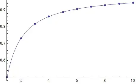

You can get a good approximation of the solution as $n \to \infty$ by supposing that $x$ can be written as an asymptotic series in powers of $1/n$, say
$$ x \sim 1 + \sum_{k=1}^{\infty} \frac{a_k}{n^k}, $$
then substituting this into the given equation and calculating the coefficients recursively. For example we can calculate $a_1$ and $a_2$ by writing
$$ \begin{align*} 0 &\approx \left(1 + \frac{a_1}{n} + \frac{a_2}{n^2}\right)^n + n\left(1+\frac{a_1}{n} + \frac{a_2}{n^2}\right) - n \\ &= \left(1 + \frac{a_1}{n} + \frac{a_2}{n^2}\right)^n + a_1 + \frac{a_2}{n} \\ &= a_1 + e^{a_1} + \frac{2a_2 (1+e^{a_1}) - a_1^2 e^{a_1}}{2n} + O\left(\frac{1}{n^2}\right). \end{align*} $$
By sending $n \to \infty$ we get that $a_1 + e^{a_1} = 0$ and so
$$ a_1 = -W(1), $$
where $W$ is the Lambert W function.
Then, setting the coefficient of $1/n$ to $0$ and substituting the above value of $a_1$ we find that
$$ a_2 = \frac{W(1)^3}{2(1+W(1))}. $$
Thus we have
$$ x \approx 1 - W(1) n^{-1} + \frac{W(1)^3}{2(1+W(1))} n^{-2}. $$
This approximation seems to be pretty good. Below is a plot which compares the numerical roots with the asymptotic formula for $1 \leq n \leq 10$.
This series might actually converge for large enough $n$ but I don't see how to prove it. If the implicit function theorem could be employed then you would be set.
