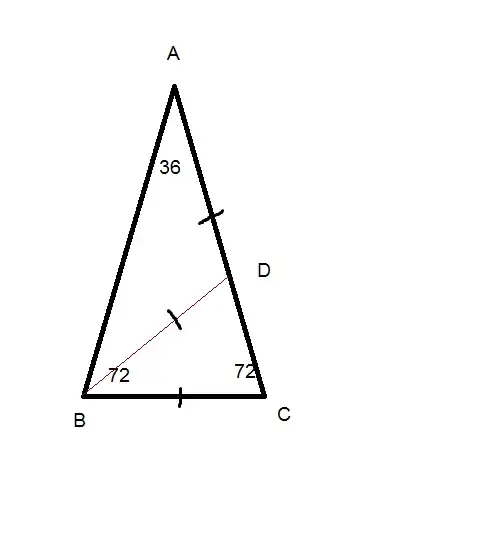

Consider this isosceles triangle:
If we bisect the base angle we create a similar triangle and we create more isosceles triangles.
If we say $AB = 1, BC = x$ then $AD = x,$ and $CD = x^2$
And, $\cos 72 = \frac 12 x$
$x+ x^2 = 1$
Solving the quadratic. $x = \frac {-1 \pm \sqrt 5}{2}$
And since we know that $x > 0$
$\cos 72^\circ = \frac {-1 + \sqrt 5}{4}$
$\cos 108^\circ = - \cos 72$ by symmetry about $90^\circ$
We use double angle or half angle formla to find
$\cos 36^\circ$ or $\cos 144^\circ$
And complimentary / suppimentary formula to find $\sin 54^\circ$
