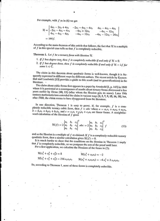

The general rule involved: take your homogeneous ternary cubic. Write down the Hessian matrix of second partial derivatives. The entries of this matrix are linear in the variables. Finally, take the determinant, call that $\mathcal H.$
The theorem is this: the original form, call it $f(x,y,z),$ factors completely into three linear factors (over the complex numbers) if and only if $\mathcal H$ is a constant multiple of $f.$
G. Brookfield: enter image description here

There is an article in the American Mathematical Monthly calling this identity Gauss's Gem, see here. So I suppose, Spanish and English have something in common concerning this identity.
