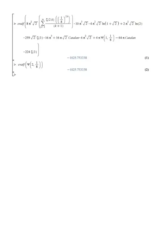

Psi(2,1/8)
I find this formula with Maple,consider the sum and we obtain an expression of Psi(1,1/8).
