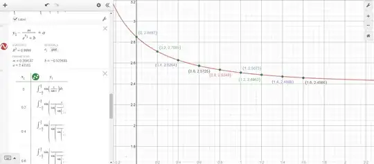

Here is a very nice graph showing the likely convergence of $f_n$:
The $R^2$ value is extremely close to $1$, and the best fit curve is given by the equation $$y=\frac{0.2091}{e^x-0.5226}+2.411$$ which implies that $$L\approx2.411$$
Are there any analytic techniques to prove this?
