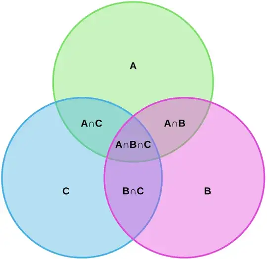

I think it is easier to visualize the formula for smaller n. For, n=3, you can use the standard Venn Diagram below.
$E_3=S_3$ is the central part $|A\cap B\cap C|$.
$E_2=|A\cap B \setminus A\cap B\cap C| +|A\cap C \setminus A\cap B\cap C|+|B\cap C \setminus A\cap B\cap C|.$
$S_2=|A\cap B | +|A\cap C |+|B\cap C|.$
Notice that $S_2$ counts the elements in $A\cap B\cap C$ three times.
The the second term on the right hand side of the $E_m$ formula removes the thrice counted elements from $A\cap B\cap C$.
$E_2= S_2 - {2+1\choose 1} S_3.$
$$ $$ $E_1= |A\setminus (B\cup C)| + |B\setminus (A\cup C)| + |C\setminus (A\cup B)|$.$
$S_1=|A| + |B| + |C|.$
Notice that $S_1$ counts the elements in $A\cap B \setminus A\cap B\cap C$ twice and counts the elements in $A\cap B \cap C$ three times.
$E_1= S_1 - {1+1\choose 1} S_2 + {1+2\choose 2} S_3.$
The second term removes the points in $A\cap B \setminus A\cap B\cap C$ from $S_1$ which were counted twice. The second term also corrects $S_1$ for the points in $A\cap C \setminus A\cap B\cap C$ and $B\cap C \setminus A\cap B\cap C$. However, the points in $A\cap B \cap C$ need to be removed also. The $S_1$ term counts these thrice. The ${1+1\choose 1} S_2$ term subtracts 6 for each point in $A\cap B \cap C$. The last term adds these points 3 times, so overall they have no effect on the right hand side.
You can repeat the same reasoning for any $n>3$ and $m\geq n-2$.
