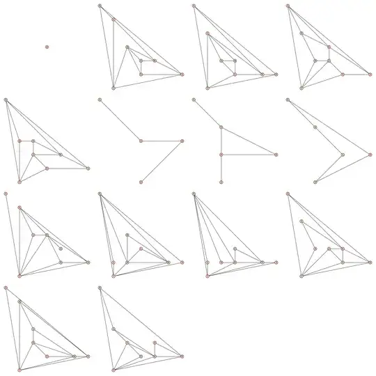

As it appears there are only 14 such graphs and they can be seen in the attached figure!

    Nice enumeration. Still three remarks: 1. A selfcomplementary graph has $n(n-1)/4$ edges and not $n(n+1)/4$. You then derive $3\leq n\leq 10$ from this. 2. Every sequence in $\mathcal O(n)$ is also in $\mathcal O(n^2)$. What you actually want to say is that the edge count of self-complementary graphs is in $\Omega(n^2)$, but the edge count of planar graphs is in $o(n^2)$, which are disjoint. 3. It can be argued to include the empty graph in the list. – M. Winter Aug 11 '17 at 15:47
  • The correct case analysis (see above Comment by @M.Winter) requires us to consider $n=9$ (since $n(n-1)/4$ is an integer when $n\equiv 0,1 \bmod 4$). There are no such solutions, but it is not an obvious conclusion. Fortunately pertinent references are given in Answer to this previous Question. – hardmath Aug 12 '17 at 00:08
