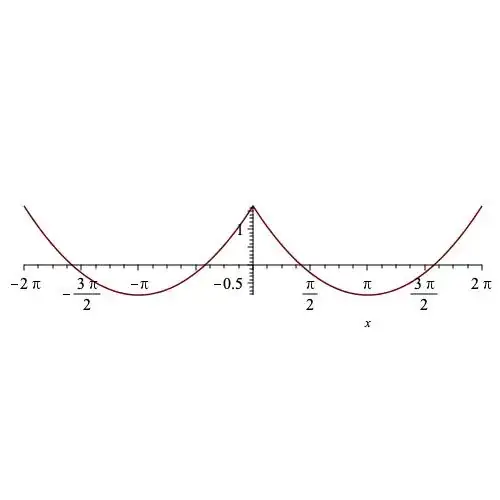

Begin with $$ f ( x ) = \frac { x ^ { 2 } } { 4 } - \frac { \pi x } { 2 } + \frac { \pi ^ { 2 } } { 6 } $$ for $x \in [0,2\pi]$, and the corresponding $$ f ( x ) = \frac { x ^ { 2 } } { 4 } + \frac { \pi x } { 2 } + \frac { \pi ^ { 2 } } { 6 } $$ for $x \in [-2\pi,0]$. So $$ \lim_{h \to 0^+}\frac{f(h)-f(0)}{h} = \lim_{h\to 0^+}\frac{h^2/4+\pi h/2}{h} = \frac{\pi}{2} $$ and $$ \lim_{h \to 0^-}\frac{f(h)-f(0)}{h} = \lim_{h\to 0^-}\frac{h^2/4-\pi h/2}{h} = -\frac{\pi}{2} $$ Therefore, $$ \lim_{h \to 0}\frac{f(h)-f(0)}{h} $$ does not exist.
Picture of the graph of $f$, showing the non-differentiable point.
