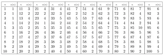

The numbers $a(n)$ for all natural $n\le 100$ are listed in [KN]:
