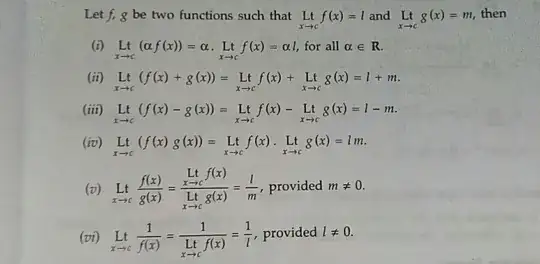

  • Aren't they the basic properties of limit. Let me upload a pic. –  Sep 12 '18 at 12:08
  • These properties are mentioned in every book. –  Sep 12 '18 at 12:12
  • Look at (v) in your picture. It requires $m \neq 0$. In your method 1, is this condition satisfied? – xbh Sep 12 '18 at 12:15
  • Oops. Another thing is written in my book(I'll upload a pic). Is this also a mistake –  Sep 12 '18 at 12:18
  • So does it mean that my this step is wrong $$= \ \ \ \ \dfrac{\displaystyle \lim_{x \to 0}e^x-\lim_{x \to 0} 1}{\displaystyle \lim_{x \to 0}x}$$
