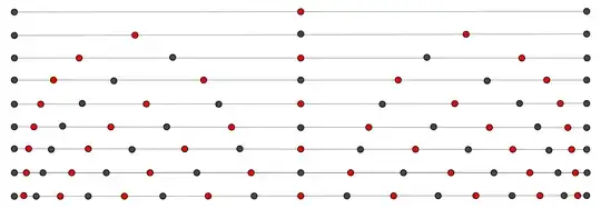

An illustration, for $n = 1$ to $9$:

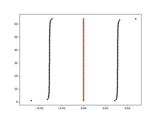

A pattern is visible when one displays the subintervals
$[t_{i-1}, t_i]$ with the interior points $y_i$ aligned vertically.
For $n = 64$:
If we define $u_i = y_i - t_{i-1} = t_{n-i+1} - y_{n-i+1}$ ($i = 1, 2, \ldots, n$), then $\sum_i u_i = (t_n - t_0)/2 = 1$, and the following approximation seems surprisingly accurate: $$ u_i \bumpeq \frac{1}{2n + 1}\left( 2 + \frac{1}{n\tan(\pi\eta)}\tan\left( \frac{\pi}{2}\left( 1 - \frac{2i - 2\eta - 1}{n} \right)\right)\right), $$ where the 'optimum' value of $\eta$ depends on $n$, but seems to consist of a constant term of about $0.348$ plus a small positive term of order about $n^{-2}$. Like the $u_i$ themselves, the approximate values sum exactly to $1$, thanks to this identity: $$ \tan\theta = \frac{1}{n}\sum_{i=1}^n\tan\left(\frac{\pi}{2} - \frac{(2i-1)\pi}{2n} + \frac{\theta}{n}\right) \quad \left(n \geqslant 1, \ \theta \ne k\pi + \frac{\pi}{2}\right). $$ (Proof: see here or here.)
