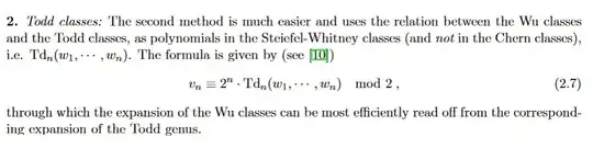

A direct method for the computation of the Wu classes is presented in https://arxiv.org/pdf/1109.4461.pdf
The following paragraph shows the method.
enter image description here The equation (2.7) is implemented via Maple using the package Schubert, according with the following code:

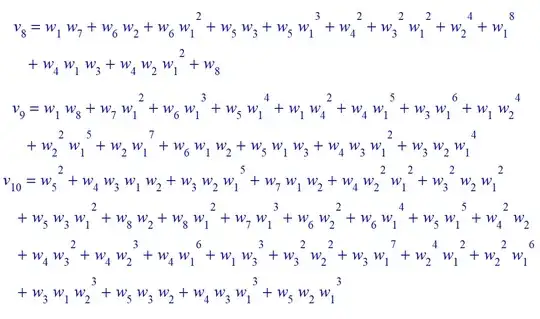

restart:with(schubert); DIM:=15: b:=bundle(15,c): eq:=todd(b): aux:={c1=w1,c2=w2,c3=w[3],c4=w[4],c5=w[5],c6=w[6],c7=w[7],c8=w[8],c9=w[9],c10=w[10],c11=w[11],c12=w[12],c13=w[13],c14=w[14],c15=w[15]}; for i from 1 to 11 do print(v[i]=subs(w1=w1,subs(aux,coeff(todd(b),t,i)*2^i) mod 2)) end do;
Executing such code we obtain
