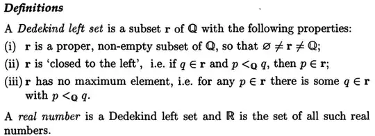

I must provide you with definition of Dedekind left set because it's important to understand the exercises: enter image description here
FACEPALM. So far so bad. "A real number is Dedekind left set" doesn't make sense to me. A number and a set are two different things. Yes, there can be a set whose the only element is a number, but it does't make the set itself a number.

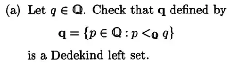

Now let's look at the first exercise: enter image description here
Definition of set q is absurd. It basically says "We have set q that consists of rational numbers and each its rational number has following property: namely any rational number that is less than any rational number". But there is no such number! It could make sense if we were comparing a set of negative numbers to a set of positive numbers, after all any negative number is less than any positive number. But we don't compare sets of negative and positive numbers, so in this case we get empty set.

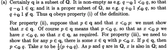

Let's check the solution: enter image description here enter image description here
1.This is not clear what enter image description here means. Does it mean "q+1 isn't less than q when assumed that q is a rational number"? If yes, then why don't we just write it down as "q+1 is more than q when assumed that q is a rational number"? It's more straightforward. Besides, if we adopt the interpretation it's unclear why should we conclude that q is a proper subset of all rationals.
2.I'm not sure how to interpret enter image description here and why should it mean that set q can't be empty. My best guess is that it means "For any rational number there is always smaller rational number exists. Thus the set is NOT empty". I agree with the premise, but I don't see how the conclusion follows from it.
3.The rest of the solution is unclear for me too, but I guess I'll be able to understand it if I will have clear understanding of already mentioned places that confuse me.

Let's start with $$\textbf{q} =\{p\in\mathbb {Q} \mid p<_{\mathbb{Q}} q\} $$ Here $q$ is a specific rational number (you can think of some example like $q=1$ in your mind if that helps). And $\textbf{q} $ is a specific subset of $\mathbb{Q} $ which depends on rational number $q$. In simple English $\textbf{q}$ is the set of all rationals which are less than $q$ (for example you might consider the set of all rationals less than $1$).
To show that this set $\textbf{q} $ is Dedekind left set just check that it satisfies the three properties given in the definition of Dedekind left set.
It is clearly not empty because there are many rationals less than $q$ (in particular $q-1$ is one of them) and they all belong to set $\textbf{q}$. Also it is a proper subset of $\mathbb {Q} $ because there are many rationals which don't belong to it (precisely $q$ and all greater rationals don't belong to $\textbf{q}$).
Next property of Dedekind left set when translated into English reads like "if a rational number belongs to a Dedekind left set then all the smaller rationals also belong to it". If some rational $x\in\textbf{q}$ then by definition of set $\textbf{q} $ we have $x<q$ and clearly all rationals less than $x$ are also smaller than $q$ so that all rationals smaller than $x$ also belong to $\textbf{q} $. Thus the second property is also verified for $\textbf{q} $.
The final property of Dedekind left set needs to be verified for $\textbf{q} $ and it reads that "there is no greatest member in $\textbf{q} $" ie "if a rational $x$ lies in $\textbf{q} $ then there is another greater rational $y$ which also lies in $\textbf{q}$". Let $x\in\textbf{q}$ then we have $x<q$ and the rational number $y=(x+q) /2$ is such that $x<y<q$. Since $y<q$ we have $y\in\textbf{q} $ and thus we have found a $y$ greater than $x$ which lies in $\textbf{q}$.

So the book defines a type of set. A Dedekind left set. The definition makes sense. And by definition we are going to call a Dedekind left set a "real nummber". This is fine! We could have called a Dedekind left set a "pickle sandwich" if we wanted to. It does not matter that "real number" means something different in CONTWGUW. We are not ever going to use CONTWGUW ever again.
So. Is $r_* = \{q\in \mathbb Q| q\le \frac 12\}$ a 'real number' or a Dedekind left set.
No, it is not because it has a maximum element, $\frac 12$ and a 'real number' (which is a type of set) doe not have a maximum element.

"This is not clear what $q +{\mathbb Q} _1 \not < q$ means. Does it mean "q+1 isn't less than q when assumed that q is a rational number"?
Yes, it means exactly that.
"If yes, then why don't we just write it down as "q+1 is more than q when assumed that q is a rational number"? It's more straightforward."
Why is that more straightforward? We want to show that $q+1 \not \in q_*$ and $q+1 \in q_* \iff q+1 < q$. So we want to show it is not true that $q+1 < q$. i.e. we want to show that $q+1 \not < q$.
"Besides, if we adopt the interpretation it's unclear why should we conclude that $q_*$ is a proper subset of all rationals. "
Um, $q_* = \{p\in \mathbb Q| p< q\} \subset \{p \in \mathbb Q\} = \mathbb Q$. So it is a subset. We just need to show it is a proper subset. It is not empty because $q -1 \in \mathbb Q$. And it is not all of $\mathbb Q$ because $q + 1\not \in \mathbb Q$. So it is a proper subset.
"I'm not sure how to interpret $q-_{\mathbb Q}1 <_{\mathbb Q} q$ here and why should it mean that set $q_*$ can't be empty. My best guess is that it means "For any rational number there is always smaller rational number exists. Thus the set is NOT empty". I agree with the premise, but I don't see how the conclusion follows from it."
If means $q - 1 < q$ . Thus $q-1 \in \{p\in \mathbb Q|p < p\}=q_*$. Thus $q_*$ is not empty.
The two remaining things we have to do are:
ii) Show that if $p \in q_*$ and $r < p$ ($r$ is rational) then $r \in q_*$.
This is clear. If $p \in q_*$ then $p$ is rational and $p < q$. And if $r < p$ and $p < q$ then $r < q$ and therefore $r\in q_*$.
iii) Sow that $q_*$ has no maximum element.
If can't. If $r \in q_*$ then $r$ can not be maximal. Because $r< \frac {r+q}{2}< q$ . So $\frac {r+q}2 \in q_*$.
So All the conditions of a Dedekind left set are fullfilled.
So $q_*$ is a Dedekind left set. So it is what we are calling a 'real number'.
