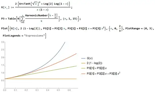

Nothing on the closed form so far, but we can derive a double integral expression for the second sum which might be useful:
$$\sum_{k=1}^n \frac{H_{k-a}}{k}=\int_0^1 \int_0^1 \left(\frac{1-v^n}{1-v}-t^{1-a} \frac{1-(t v)^n}{1-t v} \right) \frac{dv dt}{1-t} \\ a<1$$
In particular:
$$p_3(n)=\int_0^1 \int_0^1 \left(\frac{1-v^n}{1-v}-\sqrt{t} \frac{1-(t v)^n}{1-t v} \right) \frac{dv dt}{1-t}$$
We can also derive a nice looking generating function:
$$G(x)=\sum_{n=1}^\infty p_3(n) x^{n-1}= \frac{1}{1-x} \int_0^1 \int_0^1 \left(\frac{1}{1-xv}- \frac{\sqrt{t}}{1-x t v} \right) \frac{dv dt}{1-t}$$
From which follows:
$$(1-x) G(x)= \sum_{q=0}^\infty \frac{H_{q+1/2}}{q+1} x^q$$
This series appears to have a closed form, as can be seen from checking particular values of $x$ in Wolfram Alpha, such as $x=1/3$ or $x=1/5$.
For example:
$$ \frac23 G \left(\frac13 \right)=\frac32 \left(4 \log^2 2-4 \log 2 \log 3+2 \log 2 \log (\sqrt{3}-1)- \\ -4 \log( \sqrt{3}-1) \log( \sqrt{3}+1)+ \log^2 (\sqrt{3}+1)-\log^2 (\sqrt{3}-1) \right)$$
For $x=1/2$ the closed form contains dilogarithms, but maybe it can be simplified.
If we find a closed form for $G(x)$, then the problem formally reduces to differentiating $G(x)$ and evaluating the derivatives at $x=0$.
Update
With the help of Mathematica I have derived the following simple closed form for the generating function:
$$G(x)= \frac{2}{x(1-x)} \left( \operatorname{arctanh}^2 \sqrt{x}+\log 2 \log (1-x) \right)$$
I have checked a few derivatives and it works.
Note:
$$p_3(n+1)= \frac{1}{n!} \lim_{x \to 0} \frac{\partial^n}{\partial x^n} G(x)$$
Here's an illustration:
