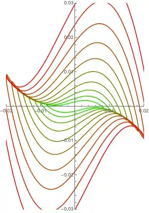

We should note that $f$ is not locally convex around $(0,0)$. For example you can check that, \begin{equation} \begin{bmatrix} 2 \\ -1 \end{bmatrix}^\top \nabla^2 f(t,t) \begin{bmatrix} 2 \\ -1 \end{bmatrix} = -12t^2 < 0, \end{equation} for all $t \neq 0$, no matter how small.
It seemed that there existed a unique minimum for a small enough linear perturbation, however upon closer inspection the gradient map is not injective. I have plotted (rotated and resized) $\nabla f(r\cos \theta, r\sin\theta)$ with $r$ fixed smaller and smaller, and with $\theta$ varying from $0$ to $2 \pi$. It seems to describe a deformed circle around $(0,0)$ (it actually becomes close to a segment) but those circles actually overlap (see the attached plot). In any case the equation is, \begin{equation} \begin{bmatrix} 4 x^3 + 24 x y^2 + 2 (x + 2 y) \\ 24 x^2 y + 4 y^3 + 4 (x + 2 y) \end{bmatrix} = \begin{bmatrix} -u \\ -v \end{bmatrix}. \end{equation}
Arcs of the gradient are drawn, $\nabla f(r \cos t, r \sin t)$, for $r=10^{-7}(1+n/4)$ with $n=1,\dots,10$ and $t = 0 \dots 2\pi$. The picture has been rotated and stretched to show clearly the overlap.
Plot of the arc of the gradients for small and varying radius.

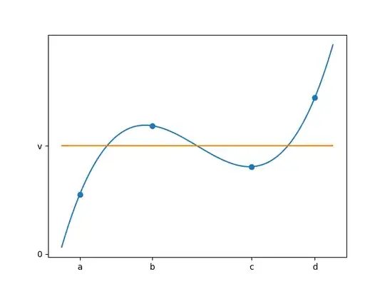

It follows we may choose $\epsilon>0$ for which $I:=[v-\epsilon, v+\epsilon]$ is contained in $[h(a),h(b)]\cap [h(c),h(d)]$. Define the sets
$$P:=h(\{x\in[a,b]:h'(x)>0\})$$ $$P':=h(\{x\in[c,d]:h'(x)>0\})$$
Lemma $(I\cap P)\cap(I\cap P')$ is non-empty.
(Proof forthcoming. It proceeds by showing that $|I\cap P| = |I|$ where $|\cdot|$ is Lebesgue measure.)
The Lemma implies that there exists $y\in(I\cap P)\cap(I\cap P')$. Thus there exist $x_1\in[a,b]$ and $x_2\in[c,d]$ for which $h(x_1)=h(x_2)=y$ and $h'(x_1)>0, h'(x_2)>0$.

  • @Blind: There was some hand-waving in the original, which I cleaned up. Also added a graph for clarity. – MathManM Oct 08 '18 at 01:28

  • Why $h(a)<v<h(b)$ we can choose $z\in [a,b]$ such that $h(z)=v$ and $h^\prime(z)>0$? Please consider $h(x)=x^3$ and $a=-1,b=1, v=0$, then $-1=h(a)<v=0<h(b)=1$ and $h(z)=v=0$ equivalent to $z=0$ but $h^\prime(z)=0$. – Blind Oct 11 '18 at 21:19
  • @Blind. You are correct; the proof is invalid as stated, but I believe the approach is correct. I will revise it this weekend. – MathManM Oct 12 '18 at 12:21
  • Thanks for your contribution. I am waiting for your revision. – Blind Oct 12 '18 at 16:57
  • @Blind. The error you identified is corrected by replacing $v$ with an interval surrounding it. The proof is still incomplete, as it relies on the unproved Lemma. I'm pretty sure I have a proof of the Lemma, but it's long, so I wanted your concurrence with what I have posted before typing up the Lemma's proof. Please let me know if you agree with what is here. – MathManM Oct 13 '18 at 14:34
