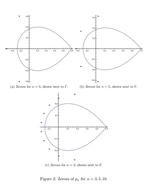

Nice question. A google search brings me to a paper of Ian Zemke, although this does not seem to have been peer-reviewed and I have not checked it myself. He apparently proves that the zeroes of $T_n(z) = \sum_{k=0}^n\frac{z^k}{k!}$ tend toward a specific curve, after normalization. That is, if $p_n(z) = T_n(nz)$, then the zeroes of $p_n(z)$ are asymptotically close to the curve $$Γ = \{z : |ze^{1−z} | = 1, |z| ≤ 1\}.$$ Thus the zeroes of the original $T_n(z)$ tend to infinity linearly with $n$.
A nice visualization from Zemke's paper:
Edit: It seems this result is actually due to Gábor Szegő from 1924. See Hans Lundmark's comment below.

    This is a famous result by Szegő from 1924. See here for some more pictures: http://users.mai.liu.se/hanlu09/complex/taylor/ – Hans Lundmark Aug 27 '18 at 04:56
    @HansLundmark Ah, thanks! I was not aware of this result. Apparently my google-fu was not up to snuff. – Jair Taylor Aug 27 '18 at 05:06
    Well, you still found a nice review paper! (I don't think Zemke claims that the proofs are original.) Here's another one, behind a paywall though: https://www.jstor.org/stable/30037629 – Hans Lundmark Aug 27 '18 at 05:11
