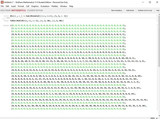

I would like to show the following is true; Let $p\in\mathbb{P}, \alpha,n\in\mathbb{N}$. Then
$$p^\alpha\mid\sum_{k=1}^{n-1}\binom{(p^\alpha-1)n}{(p^\alpha -1)k}.$$
I've never worked with prime powers inside binomial coefficients. I was hoping to see if there are any theorems, papers, or other research materials that deal with these types of objects. The reason for the belief is due to a Mathematica calculation that I ran that suggests this holds so long as the binomial coefficient involves multiples of $m=p^\alpha-1$. Here is the calculation.
The green rows represent the values of $m$ from 2 to 30 that support the divisibility claim. These numbers in order are
$$2,3,4,6,7,8,10,12,15,16,18,22,24,26,28,30$$
and these numbers, when entered into OEIS.org return that these numbers are prime powers minus one. (i ran the calculation again from $m=31..50$ to ensure this was the correct sequence, as for $m=1$ to $30$ yield a similar sequence...but i verified that $44$ is not a value of $m$ that produces divisibility). I know that this does not constitute a proof, and in NT, 40 is so small a number to test. But I reran the calculation for $n$ up to $100$ and $m$ up to $100$ and it still seems to hold. If this is true, it must be due to the nature of $p^{\alpha}-1$ as apposed to $p^{\alpha}\cdot k-1$, where $k$ is some other integer.
I know that $p^\alpha-1=(p-1)(p^{\alpha-1}+p^{\alpha-2}+...+p+1)$ but I can't see how this helps. Are there properties of cyclotomic polynomials that help?
