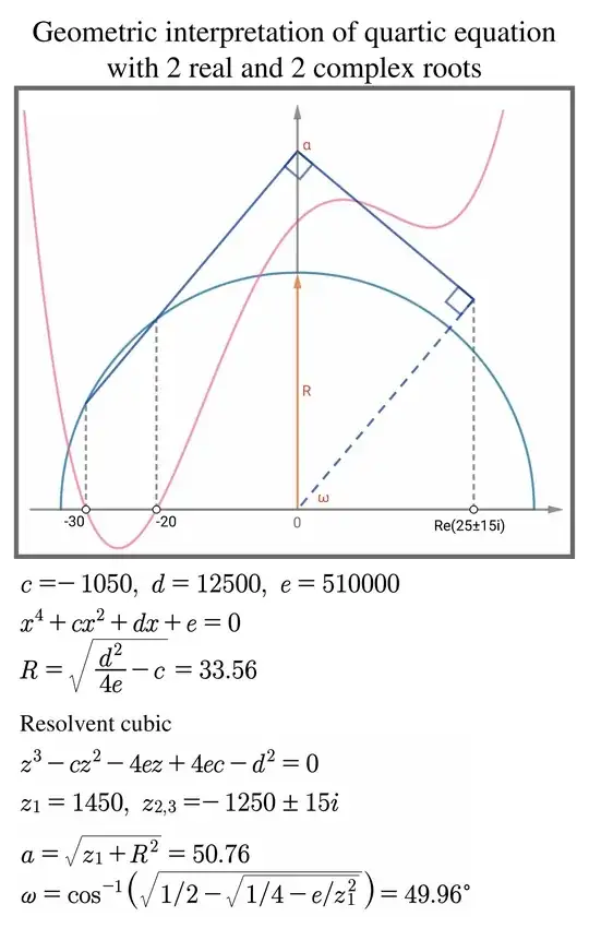

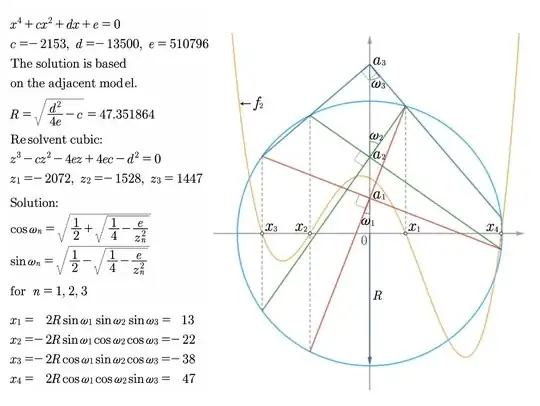

The above relations are based on the geometric interpretation of the quartic equation. I quote two relevant images:
model of quartic equation (1) model of quartic equation (2)
I add some details. To solve an equation of the form
$f(y)=y^4+By^3+Gy^2+Dy+E=0$
we first convert it to the form
$f(y-B/4)=(y-B/4)^4+B(y-B/4)^3+G(y-B/4)^2+D(y-B/4)+E$
$=x^4+cx^2+dx+e=0$
where the term $bx^3$ is absent because
$-b=x_1 + x_2 + x_3 + x_4 = 0$
From a geometric point of view, the graphs of the functions $f(y)$ and $f(y-B/4)$ are exactly the same, with the difference that the second of them has been moved parallel to the x-axis and has been installed at the beginning of the axes.
