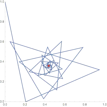

$X = i^{i^{i^{\cdot}}}$
So $X = i^X$.
So $\log (X) = X \log (i)$.
So ${\log (X) \over X} = \log (i)$.
So $X = i W(-i)$, where $W$ is the Lambert $W$ or PolyLog function.
Mathematica evaluates this to $X = 0.44 + 0.36 i$.
Here's a graph on the imaginary plane of 200 successive exponentiations with the solution as a red dot:
