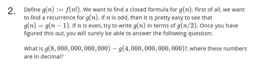

I am trying to understand the following question, and honestly have no idea from where to start it seems like it asking for factorial of $n$ terms in a form of $g(n)$?
Define $g(n):=f(n!)$. We want to find a closed formula for $g(n)$. First of all, we want to find a recurrence for $g(n)$. If n is odd, then it is pretty easy to see that $g(n)=g(n−1)$. If n is even, try to write $g(n)$ in terms of $g(n/2)$.
Can someone help thanks.

Here is the screen shot of the question enter image description here

  • I added a screen shot – COLD TOLD Aug 11 '18 at 23:03
    You provided us with a screenshot of that one specific part of a question and $f$ is not defined there. What about the question before that? What about the beginning of the section of questions? If $f$ is not defined within the paragraph you screenshotted, then it must have been defined elsewhere. – JMoravitz Aug 11 '18 at 23:04
  • Provided an f definition only definition given tin above question thru out the assignment – COLD TOLD Aug 11 '18 at 23:18
    Finally. Please provide such important definitions when you first post the question. Ironically, my second example in my second comment was almost the exact definition for $f$. Now, before working on solving the problem, we should work on making sure that you understand what is being asked. Do you understand what the function $f$ is and how to calculate for example, $f(4), f(6), f(9), f(24)$? – JMoravitz Aug 11 '18 at 23:32
    Once you are comfortable with the definition for $f$, the problem asks us to find a closed form for the function $g$, where $g$ is defined as $g(n)=\text{max}{k\in\Bbb N~\text{such that}~2^k~\text{divides}~ n!}$. For example $g(1)=0, g(2)=1, g(3)=1, g(4)=3, g(5)=3, g(6)=4$ etc... – JMoravitz Aug 11 '18 at 23:40

  • As I was reading your comments I guess it makes me a little more confused lets me state the following that I do understand 1) $g(n)=\text{max}{k\in\Bbb N~\text{such that}~2^k~\text{divides}~ n!}$ which i do get is the largest number in pover of 2 that divides n! which basically what you showed in the comment, does that mean that in order to solve $g(8000000000000)-g(4000000000000)$ I have to follow the same technique and find the larges power of 2 that divides 8000000000000? – COLD TOLD Aug 12 '18 at 02:18
  • @COLDTOLD No. You don't actually need to know the value of $g(8000000000000)$ at all. Neither do you need to know the value of $g(4000000000000)$. Again, see if you can find the simplification of $g(2n)-g(n)$. – JMoravitz Aug 12 '18 at 02:33
