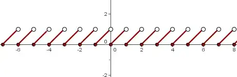

The function $$f:[0,10]\to\mathbb R\mid f(x)=x-[x]$$ is Riemann-Integrable.
Here $[x]$ is the floor function, and I think $x-[x]$ is the mantissa function:
Mantissa function

    @manooooh: I mean it does not matter that you consider $f(x) = x - [x]$. To prove the Riemann integrability, it is enough that the function considered is piecewise continuous and bounded on the interval of integration. In the case of the particular function you consider, it has to be Riemann integrable because just by looking one can calculate the area under its graph ... – Dan Fox Aug 01 '18 at 09:29
If you want to prove this by way of $$ \underline{\displaystyle\int_a^bf(x)\;\text dx}\quad=\quad\overline{\displaystyle\int_a^bf(x)\;\text dx}\,,\tag 1 $$ then it can be done. Take any $\epsilon>0$. We want to make a partition $P = (x_0, x_1, \ldots,x_n)$ of $[0,10]$ (with $x_0 = 0, x_n = 10$, and $x_i<x_{i+1}$) such that $$ U(f, P) - L(f, P)<\epsilon $$ where $U(f, P)$ is the upper sum of $f$ with respect to the partition $P$ and $L(f, P)$ is the lower. It's not too hard to show that any partition where $x_{i+1}-x_i < \epsilon/20$ will work.
