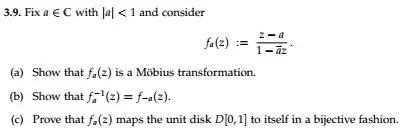

A First Course in Complex Analysis by Matthias Beck, Gerald Marchesi, Dennis Pixton, and Lucas Sabalka Exer 3.9
I got $(a)$ and $(b)$. My attempt for $(c)$:
First, I interpret that $(c)$ is equivalent to $f_a(D[0,1]), f_{-a}(D[0,1]) \subseteq D[0,1]$.
Next, for $f_a(D[0,1])$, my approach is to let $z=x+iy \in D[0,1]$, i.e. $|z|^2 = x^2+y^2 < 1$ and then plug it in $f_a$:
$$f_a(x+iy) = \frac{(x+iy)-(Re(a)+i Im(a))}{1-(Re(a)+i Im(a))(x+iy)} = \frac{AC+BD}{C^2+D^2} + i\frac{BC-AD}{C^2+D^2}$$
where
$$A := x - Re(a)$$ $$B := y - Im(a)$$ $$C := 1- (xRe(a)+yIm(a))$$ $$D := xIm(a)-yRe(a)$$
Now $$f_a(x+iy) \in D[0,1] \iff |f_a(x+iy)| < 1 \iff |f_a(x+iy)|^2 = \frac{A^2+B^2}{C^2+D^2} < 1$$
$$\iff 0 < (1-|a|^2)(1-|z|^2).$$
Finally, for $f_{-a}(D[0,1])$, I hope that we will similarly have that
$$f_{-a}(x+iy) = \frac{(x+iy)+(Re(a)+i Im(a))}{1+(Re(a)-i Im(a))(x+iy)} \in D[0,1]$$
  1. Where have I gone wrong, and why?
  2. How could I have more efficiently shown that $f_a(x+iy), f_{-a}(x+iy) \in D[0,1]$? Perhaps polar? Or is this exercise indeed meant to be gory?
