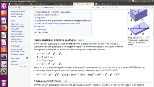

It really is a four variable parametrization, coming from quaternion multiplication. The attribution in wikipedia is to the number theorist V. A. Lebesgue. He did publish on this in the 1850's. However, this was surely known to Euler.
Discussed in detail in Pall 1940

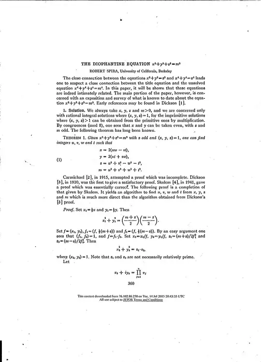

Meanwhile, the first acceptable proof that ALL quadruples arise this way (primitive ones, that is) was due to L. E. Dickson in 1920. There is a very nice article by Spira, let me find a link. I also have a pdf of Spira (1962).
