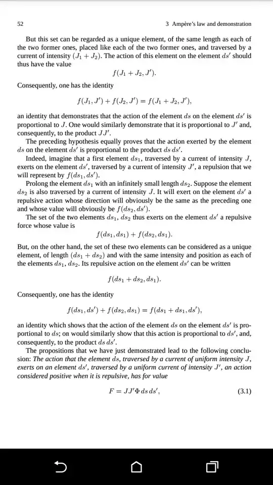

If $f(x)+f(y)=f(x+y)$, then:
$f(x)=a x$
where $a$ is a constant.

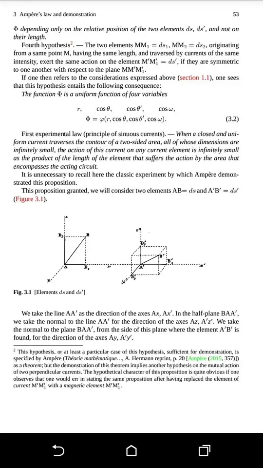

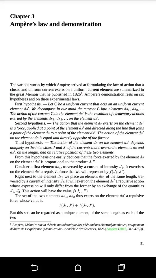

Is the above statement true? Is there a way of proving it?
The application of this theorem is in the last part of page 52 (second page of the chapter)
enter image description here enter image description here enter image description here

Hard to say anything unless you state the sets the function is defined on.
If we are considering functions $\mathbb{R} \to \mathbb{R}$, this is known as Cauchy's functional equation.
To summarize the Wikipedia article, if you also require $f$ to satisy any of the below conditions, then $f(x) = ax$ is the only family of solutions:
  • $f$ is continuous at at least one point
  • $f$ is monotonic on any interval
  • $f$ is bounded on any interval
  • $f$ is Lebesgue measurable
As this is being used for an application, I would guess that it is being assumed $f$ is continuous at at least one point, implying that $f(x) = ax$.
The wikipedia article also mentions that any other solutins are highly pathological; if you were to graph them, the graph would look like you are just shading the paper. More formally, if you take a disk of any size anywhere on the paper, that disk will contain a point $(x, f(x))$ of the function.
Let me know if anything needs clarification.

  • Thank you very much for the answer... (1) Can you please give a reference to a proof of this theorem if it is not that much intricate for a physics graduate student. (2) How can a function be discontinuous at every point. It seems impossible for me to imagine such a function. – Joe Jul 19 '18 at 15:09
  • I haven't yet studied bounded and Lebesgue measurable functions in my course. – Joe Jul 19 '18 at 15:18
  • I have read the Wikipedia article and now I understand how a function can be discontinuous at every point. Can you show me in my problem (page 52) that the function under consideration is not discontinuous at every point. – Joe Jul 19 '18 at 17:45
  • @Joe I've edited the question with info about your comments. I don't know physics, so I think you may have more luck with your quetion about page $52$ on physics stackexchange or electrical engineering stackexchange https://physics.stackexchange.com/ https://electronics.stackexchange.com/ – Ovi Jul 19 '18 at 17:58
