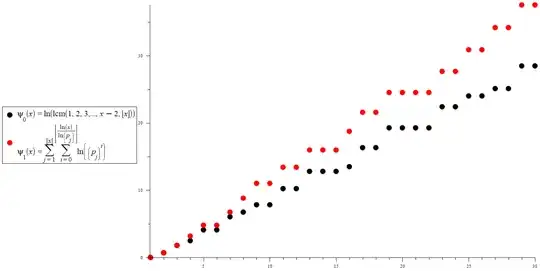

Beyond $0<n<32$ I am not as yet able to produce a result, float approximations continue to imply that the value is 0 up to $n=40$, however really what is needed here is someone with more experience in number theory to assess the situation and give an opinion as to whether it is worth pursuing or not.enter image description here

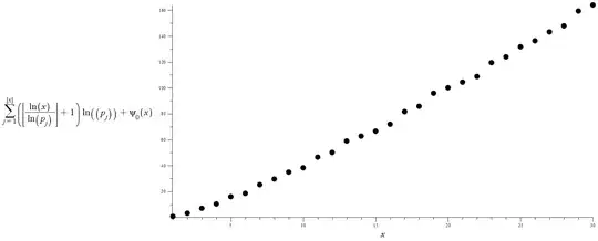

The asymptotic relation I think I originally started from, which think is actually false as I originally stated, but again, just curious about the division relation on the naturals I really am new to asymptotics:
$$\sum _{j=1}^{ \lfloor x \rfloor } \left( \Bigl\lfloor {\frac {\ln \left( x \right) }{\ln \left( p_{{j}} \right) }} \Bigr\rfloor +1 \right) \ln \left( p_{{j}} \right)+\psi_{{0}}(x) \sim x $$ enter image description here

  • I can't prove it, but it looks like $\psi_1(n)\sim \psi_0(n)\sim n$ (the second one follows from the prime number theorem but I can't prove the first yet). – Carl Schildkraut Jul 15 '18 at 22:21
  • I added a plot that I think confirms what you are saying – Adam Ledger Jul 15 '18 at 22:44
  • The first part of what you have said looks to be very much true from: $$\Bigl\lfloor \frac{\max(\psi_0(n),\psi_1(n))}{\min(\psi_0(n),\psi_1(n))}\Bigr\rfloor=1,1,1,1,1,1...$$ – Adam Ledger Jul 15 '18 at 23:01
  • I am very sure they can be related to one another as the actual Chebyshev functions are with one another somehow. – Adam Ledger Jul 15 '18 at 23:03
