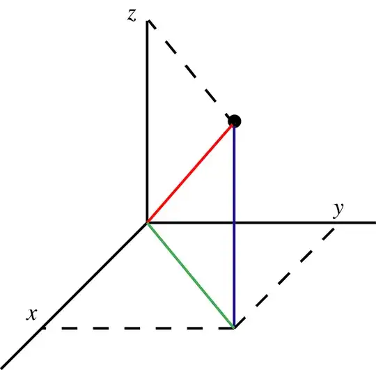

You can think of it as doing the pythagorean theorem twice. Imagine you have the vector (x,y,z) denoted by the red line in the figure below. The magnitude of the green line is given by
$\sqrt{x^2+y^2}$
and the magnitude of the blue line is $z$. So when you use the pythagorean theorem on the triangle made up of the red, green, and blue lines you get
$\sqrt{\sqrt{x^2+y^2}^2 + z^2} = \sqrt{x^2+y^2+z^2}$

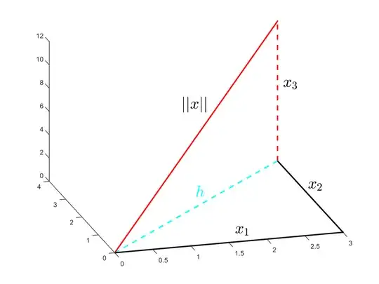

This is similar to Mr Z.'s answer, but I want to contribute my own version of the figure.
We are visualizing a vector $x = (x_1,x_2,x_3)$. From the Pythagorean theorem, the length $h$ of the line segment shown in blue is $$ h = \sqrt{x_1^2 + x_2^2}. $$ Using the Pythagorean theorem again, we see that the length of $x$ is $$ \|x\| = \sqrt{h^2 + x_3^2} = \sqrt{x_1^2 + x_2^2 + x_3^2}. $$

2I'll second @ChaseRyanTaylor... there's no point in re-posting. There are now 3 identical answers. It's good that you wanted to add a better image: the answer you mentioned does have a pretty out-of-scale figure. But it would have been better if you had simply suggested an edit on that one, and mentioned in the edit summary that the original image is confusing/misleading. – Jul 01 '18 at 04:35
2I agree it's the same, but I didn't feel comfortable replacing the image in the other answer, and I thought this image might have some usefulness to other people. If anyone is preparing slides on this topic, for example, they can feel free to use this image. It took me about half an hour to make it. There is little harm in posting it and potentially some value. – eternalGoldenBraid Jul 01 '18 at 08:19
1@eternalGoldenBraid I do think your image and use of h variable is clearer, because it helped me a bit grasping the concept immediately. Thanks! – 1d0m3n30 Jun 26 '20 at 10:49

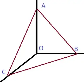

A different variation of the Pythagorean theorem in 3D: This one relates areas!
The black lines are perpendicular to each other.
$Area(\Delta ABC)^2 = Area(\Delta OAB)^2 +Area(\Delta OAC)^2 +Area(\Delta OBC)^2 $
- 3,476
3FYI: This is known as de Gua's Theorem. Its further generalizations into higher dimensions relate squares of "measures" of higher dimensional simplices. – Blue Jul 01 '18 at 02:16
Thanks. I didn't know it by name. Only by playing around with math in High School. One can also use this fact to derive Heron's formula for the area of a triangle, given the edge lengths. I don't remember how, so it's left as an exercise to the reader. – Josh B. Jul 01 '18 at 02:19
