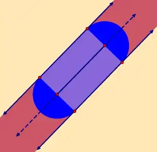

If I understand your edit correctly, you have a point $C=(x_c,y_c)$ and the line segment with endpoints $P=(x_1,y_1)$ and $Q=(x_2,y_2)$ and you want to know whether or not $C$ is within a distance $r$ of any point on the line segment $\overline{PQ}$.
Working from Tom Stephens's answer, let's look at the whole line $\overleftrightarrow{PQ}$ containing the line segment $\overline{PQ}$. The distance between $C$ and $\overleftrightarrow{PQ}$ is $d=\frac{|(x_1 - x_2)(x_c-x_1) + (y_2 - y_1)(y_c-y_1)|}{\sqrt{(x_1-x_2)^2 + (y_2-y_1)^2}}$.
(1) If $d>r$, then $C$ is too far from $\overleftrightarrow{PQ}$ to be within $r$ of any point on $\overline{PQ}$, finished.
If $d\le r$, then $C$ is close enough to $\overleftrightarrow{PQ}$, but may not be close enough to $\overline{PQ}$. $d$ is the perpendicular distance from $C$ to $\overleftrightarrow{PQ}$. Consider two cases—first, that $C$ and $\overline{PQ}$ are arranged such that the perpendicular distance is to a point on $\overline{PQ}$; second, that the perpendicular distance is to a point not on $\overline{PQ}$.
(2) In the first case, $\angle PQC$ and $\angle QPC$ each have measure ≤90°, so the cosine of each angle must be nonnegative so $\frac{(x_1-x_2)^2-(x_1-x_c)^2+(x_2-x_c)^2+(y_1-y_2)^2-(y_1-y_c)^2+(y_2-y_c)^2}{2\sqrt{((x_1-x_2)^2+(y_1-y_2)^2)((x_2-x_c)^2+(y_2-y_c)^2)}}\ge 0$ and $\frac{(x_1-x_2)^2+(x_1-x_c)^2-(x_2-x_c)^2+(y_1-y_2)^2+(y_1-y_c)^2-(y_2-y_c)^2}{2\sqrt{((x_1-x_2)^2+(y_1-y_2)^2)((x_1-x_c)^2+(y_1-y_c)^2)}}\ge 0$ (from the Law of Cosines). [ edit 2: After a more careful reading of damiano's answer, it occurred to me that these are much more hideously complicated than necessary. The denominators do not affect the sign at all and the numerators are somewhat simpler when expanded, so the two inequalities can be replaced by: $x_1x_2-x_1x_c+x_2x_c-x_2^2+y_1y_2-y_1y_c+y_2y_c-y_2^2\ge0$ and $x_1x_2+x_1x_c-x_2x_c-x_1^2+y_1y_2+y_1y_c-y_2y_c-y_1^2\ge0$. These are more clearly equivalent to damiano's vector-dot-product criteria. ] If both of these inequalities hold, then $d\le r$ is the distance from $C$ to $\overline{PQ}$, so $C$ is within $r$ of $\overline{PQ}$.
(3) If those two inequalities from the Law of Cosines do not both hold, then $d$ is not the distance from $C$ to any point on $\overline{PQ}$, so the shortest distance from $C$ to any point on $\overline{PQ}$ is the distance to the closer of $P$ and $Q$: $d'=\min(\sqrt{(x_1-x_c)^2+(y_1-y_c)^2},\sqrt{(x_2-x_c)^2+(y_2-y_c)^2})$. If $d'\le r$, then $C$ is within $r$ of $\overline{PQ}$.
edit (adding the numbers above, also):
Given Corey Ogburn's answer, I thought it might be helpful to add a diagram and discuss what parts of my original answer address which regions. The numbers below discuss the correspondingly-numbered part of my original answer, above.
diagram
(1) If $d>r$, then the point $C$ is in the beige region.
(2) $d\le r$, so if $\angle PQC$ and $\angle QPC$ each have measure ≤90°, then $C$ is in the purple region.
(3) $C$ is not in the beige or purple regions, so we only need to see whether it's in the blue or red regions (based on whether $C$ is close enough to the endpoints of the segment).

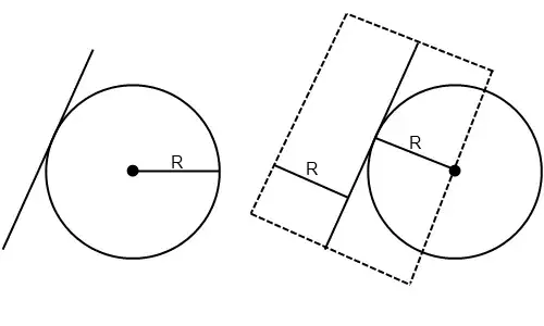

-1
Dear God you guys over complicated things...
Not being a math expert along the lines of you guys, I set the problem down and came back to it later. Upon looking it over again, I realized I could really simplify this by using the given data to look at it as different geometry. Instead of a line segment and a circle and testing for intersection, I used the radius of the circle to convert the line to a rectangle and then checked if the center of the circle (as just a point, no longer as a circle) is inside the new rectangle. Line Circle Intersect Using New Geometry
Please excuse my rectangle not having perfect dimensions.
EDIT:
Although my answer meets my needs for my specific application, to better answer my own question, about the semi circles at the end of the rectangle (to test if an endpoint of the line segment is contained in the circle), I can compare the distance between an endpoint and the center of the circle, if that distance is less than the radius of the circle, the circle contains the end point.
My application was for a Tower Defense game. The line represented some sort of laser stretched across the trail that enemies (the circle) would walk past, I needed to know when the laser contacted the enemy. The laser endpoints are attached to towers that are not positioned on the path the enemy walks down, so the enemy's circle could not contain an endpoint. I realize I was unclear during the original question about some of these details.
    This misses the cases where the center of the circle is outside your rectangle, but close enough to the endpoints of the line segment to be within R of the line segment. That is, there should be semicircles added at the 2R-long sides of the rectangle. – Isaac Sep 22 '10 at 18:33
    Ahh, given your application, yes, methods like my full answer are overkill. I don't know how you specifically implemented the test in the end, but given the coordinates of the point and the endpoints of the line segment, the explicit formula for the distance between that point and the line containing the segment would make for a relatively simple-to-program test. (This is the step labeled (1) in my answer, using the formula immediately above that step.) – Isaac Sep 25 '10 at 21:41
