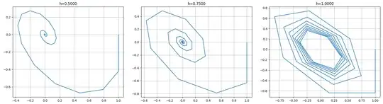

numerical solution for 3 step sizes
While the exact solution converges very rapidly towards the origin, with a bit more than one visible rotation about zero, the numerical solution with step size $h=0.5$ still somewhat shows that rapidity while $h=0.75$ has a rather slow convergence and $h=1$ looks undecided if it approaches the origin at all.
