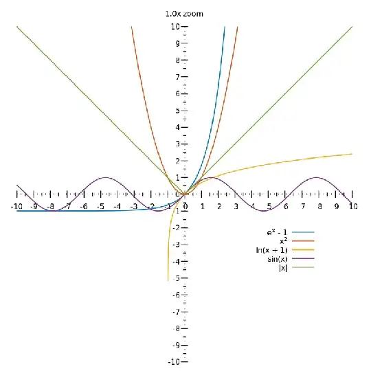

To find the gradient of a curve at a given point, you need to keep zooming in:
zooming on curves
From the above animation, you can guess the gradients of the different curves (either $0$, $1$ or undefined) but in order to be sure, you'd need an $\infty$ zoom.
This process of "zooming in indefinitely" is why you need the concept of limits when defining the derivative.
PS: I used the same animation as in one of my previous answers.
Eric Duminil
  • 3,572
    Amazing. I mean we all teach derivatives by "how a function looks very close", but I never had the idea to actually show a video of zooming in. I always trust in the imagination of my students. But this is better. – M. Winter Jun 27 '18 at 19:36
  • @M.Winter: Thanks for the comment! Feel free to use the animation. – Eric Duminil Jun 27 '18 at 19:55
  • Insightful. Some things become more interesting up close, others more boring (after looking at your beautiful animation I guess all continuous functions become more boring). – Peter - Reinstate Monica Jun 28 '18 at 09:37
    @PeterA.Schneider: Here's a continuous function which is less boring than the above examples. – Eric Duminil Jun 28 '18 at 13:03
    @EricDuminil Great! I had a nagging feeling when I wrote "all" ;-) – Peter - Reinstate Monica Jun 28 '18 at 14:19
    By the way, your animation is also a good visualization for $\sin x \approx x$ for small x which physicists love. – Peter - Reinstate Monica Jun 28 '18 at 14:26
    @PeterA.Schneider I guess by boring you mean featureless, or homogeneous. If so, it is this "boringess" that makes continuous functions so interesting, because they are mostly easier to deal with. Another example of a function that is not boring in your sense but that is continuous is the Weierstrass function. – Allawonder Jun 29 '18 at 11:22
