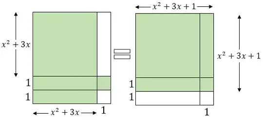

Proof without words:
$\hspace{2cm}$enter image description here $$\color{red}x\color{blue}{(x+1)(x+2)}\color{red}{(x+3)}+1=\color{red}{(x^2+3x)}\color{blue}{(x^2+3x+2)}+1=(x^2+3x+1)^2.$$

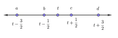

Suppose that you have 4 consecutive numbers $a, b, c, d$. They can be expressed as $a=t-\frac{3}{2}$, $b=t-\frac{1}{2}$, $c=t+\frac{1}{2}$ and $d=t+\frac{3}{2}$ for some number $t$.
Now, $$ad = \left(t-\frac{3}{2}\right)\left(t+\frac{3}{2}\right) = t^2 - \left(\frac{3}{2}\right)^2 = t^2 - \frac{9}{4}$$ and $$bc = \left(t-\frac{1}{2}\right)\left(t+\frac{1}{2}\right) = t^2 - \left(\frac{1}{2}\right)^2 = t^2 - \frac{1}{4}$$
If we define $y = t^2 - \frac{5}{4}$, we have $$ad = \left(t-\frac{3}{2}\right)\left(t+\frac{3}{2}\right) = y - 1$$ and $$bc = \left(t-\frac{1}{2}\right)\left(t+\frac{1}{2}\right) = y + 1$$
Furthermore, since the LHS in both cases is an integer, it is clear that $y$ is an integer.
So the product of all four numbers is $$ abcd = (y - 1)(y+1) = y^2 - 1 $$ one less than the square of an integer.

This is another way of looking at @jwg's answer.
Let the four consecutive numbers be $a,b,c,d$ and let $t$ be the number half-way between $b$ and $c$. Then
\begin{align} abcd + 1 &= \bigg(t-\frac 32\bigg)\bigg(t-\frac 12\bigg) \bigg(t+\frac 12\bigg)\bigg(t+\frac 32\bigg) + 1\\ &= \bigg(t^2-\frac 94\bigg)\bigg(t^2-\frac 14\bigg) + 1\\ &= t^4 - \frac 52 t + \frac{25}{16}\\ &= \bigg(t^2 - \frac 54 \bigg)^2 \end{align}
Letting $t = a + \frac 32$, we get
\begin{align} abcd + 1 &= \bigg(t^2 - \frac 54 \bigg)^2 \\ &= \bigg(a^2 +3a + \dfrac 94 - \frac 54 \bigg)^2 \\ &= (a^2 +3a + 1)^2 \end{align}
This suggests the following solution.
\begin{align} abcd + 1 &= a(a+1)(a+2)(a+3) + 1 \\ &= a(a+3) \cdot (a+1)(a+2) + 1 \\ &= (a^2+3a) (a^2+3a+2) + 1 \\ &= (a^2+3a+1 \ - \ 1)(a^2+3a+1 \ + \ 1) + 1 \\ &= (a^2+3a+1)^2 - 1 + 1 \\ &= (a^2+3a+1)^2 \end{align}
