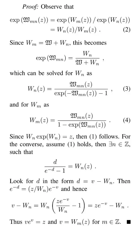

Using the equation (1)(second page of the paper)
If $d=W_0(z)-W_{-1}(z)$, $$\frac{d}{e^{-d}-1}\text{exp}\left(\frac{d}{e^{-d}-1}\right)=z$$
Here, $d=1$, and your result follows:
$$z=-\frac{e}{e-1}\text{exp}\left(\frac{e-1+1}{1-e}\right)=-\frac1{e-1} \text{exp}\left(\frac{1}{1-e}\right) $$
Proof of the equation:
Note that $\text{(strange W)}_{mn}=W_m-W_n$(I spent a while to figure this out)
