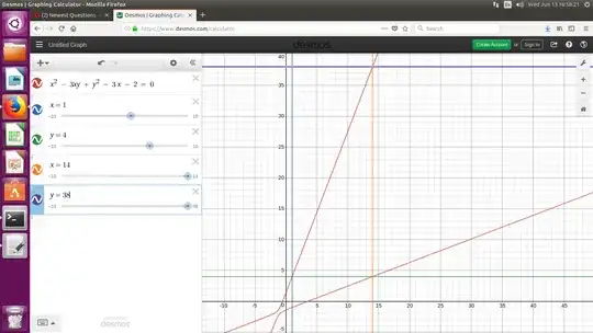

This is a slight variant of Vieta Jumping. For a given solution $(n,p)$ we can travel around the given hyperbola by $$ (n,p) \mapsto (3p+3 - n, p) $$ and $$ (n,p) \mapsto (n, 3n-p) $$ To keep going, alternate the maps. If you double any mapping you go back where you started

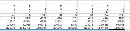

There are base solutions $n=-1,p=-2$ and $n=-2,p=-2$ Starting with either one, you can use either of two recurrences
$$n' = 3 n - 8 p - 12 \\ p' = 8 n - 21 p - 30$$
and also:
$$n' = - 21 n + 8 p - 12 \\ p' = - 8 n + 3 p - 6$$
This gives the following four sets of solutions
Answers found with the help of the Alpertron, but it missed the $-2,-2$ base solution.
