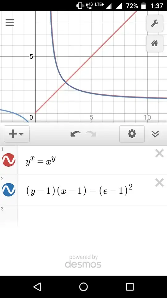

While attempting to estimate the graph of equation, $y^x=x^y $ (domain is positive real numbers) I was able to deduce that it contains two curves: a straight line $y=x$, and another curve (that LOOKS like a rectangular hyperbola but I'm pretty sure it's not) that is asymptotic at $x=1$ and $y=1$. Assuming it to be a rectangular hyperbola, and using its asymptotes and the fact that it cuts $y=x $ at $ (e,e)$ , I came up with its equation as : $(y-1)(x-1)=(e-1)^2$ . At this moment I open up a graphing software (Desmos) to check my work and I find that the Hyperbola I came up with approximates the curve very well but is quite obviously not the right one...... My question now is, can we find an explicit equation for just that particular curve (excluding the $y=x$) ? And if not, how do I modify my hyperbolic approximation so that it gets accurate at a particular value of $x$ (for instance, in the above stated approximation, it gets very accurate at $x=e$ )

1@Dhvanit. For a totally summetric model, we could use $y=\left(b+\frac c {x^a-b} \right)^{1/a}$. Now, it is lunch time here. I shall work it later today. – Claude Leibovici Jun 10 '18 at 09:48
@ClaudeLeibovici. Shouldn't the straight line come for 0<x<1 ? Because the asymptote of the 'curve' is at x=1. Or am I missing some point? – anonymous Jun 10 '18 at 10:50
1@Dhvanit. For sure, you are correct ! I was just giving the general idea. Have a look to my edit. – Claude Leibovici Jun 10 '18 at 11:13
1@Dhvanit. I suppose that $(y^{3/4}-1)(x^{3/4}-1)=\frac 43$ is a good approximation. – Claude Leibovici Jun 10 '18 at 13:29
