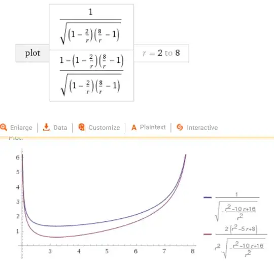

Let $0\le a\le b,$ then \begin{align} &I_1 = \int\limits_a^b \left\{ \left(1-\frac{a}{r}\right)\left(\frac{b}{r}-1\right)\right\}^{-1/2}\,\mathrm dr = \int\limits_a^b \dfrac{r}{\sqrt{(r-a)(b-r)}}\,\mathrm dr\\ &=\dfrac12\int\limits_a^b \dfrac{2r-(a+b)}{\sqrt{(r-a)(b-r)}}\,\mathrm dr+\dfrac{a+b}2\int\limits_a^b \dfrac{a+b}{\sqrt{(r-a)(b-r)}}\,\mathrm dr\\ &=-\dfrac12\int\limits_a^b \dfrac{\mathrm d((r-a)(b-r))}{\sqrt{(r-a)(b-r)}} + \dfrac{a+b}2\int\limits_a^b \dfrac{\mathrm dr}{\sqrt{\left(\dfrac{b-a}2\right)^2-\left(r-\dfrac{b+a}2\right)^2}}\\ &=-\sqrt{(r-a)(b-r)}\Bigg|_a^b + \dfrac{a+b}2\arcsin\dfrac{2r-(b+a)}{b-a}\Bigg|_a^b = \pi\dfrac{a+b}2,\\ &I_2 = \int\limits_a^b \left\{ \left(1-\frac{a}{r}\right)\left(\frac{b}{r}-1\right)\right\}^{-1/2}\left(1-\left\{ \left(1-\frac{a}{r}\right)\left(\frac{b}{r}-1\right)\right\}\right)\,\mathrm dr\\ & = \int\limits_a^b \dfrac{2r^2-(a+b)r+ab}{\sqrt{(r-a)(b-r)}}\,\dfrac{\mathrm dr}r = \int\limits_a^b \dfrac{2r-(a+b)}{\sqrt{(r-a)(b-r)}}\,\mathrm dr - ab\int\limits_a^b \dfrac{1}{\sqrt{(1-\frac ar)(\frac br-1)}}\,\mathrm d\left(\dfrac1r\right)\\ &=-\sqrt{(r-a)(b-r)}\Bigg|_a^b + ab\int\limits_{1/b}^{1/a}\dfrac{\mathrm dt}{\sqrt{(1-at)(bt-1)}} = \sqrt{ab}\int\limits_{1/b}^{1/a}\dfrac{\mathrm dt}{\sqrt{(\frac1a-t)(\frac1b-t)}}\\ &= \sqrt{ab}\int\limits_{1/b}^{1/a}\dfrac{\mathrm dt}{\sqrt{\left(\frac{\frac1a-\frac1b}2\right)^2 - \left(t-\frac{\frac1a+\frac1b}2\right)^2}} = \sqrt{ab}\arcsin\dfrac{{2t-\left(\frac1a+\frac1b\right)}}{{\frac1a-\frac1b}}\Biggr|_{1/b}^{1/a} = \pi\sqrt{ab}.\\ \end{align} This allows to present the issue integral (or the square under the graph of the according function) as the square between two other similar functions, which present AM and GM of $a$ and $b$ (see also Wolphram Alpha plot).
AM-GM
Riemann
  • 11,801
    Thanks Yuri. Solving the integral isn't the issue. Does this answer unveil any geometrical underpinnings to the integral? – zahbaz Jun 13 '18 at 21:25
  • the product in the integrand looks like the area of a rectangle (but then you take square) ... I'm with you on the geometrification of it .. like of 3-blue 1-brown ... the $\pi$ suggests a circle in the midst – phdmba7of12 Jun 15 '18 at 16:13
  • @zahbaz All the considering integrals have interpretation as the squares under graphs. The issue integral presents the difference between AM and GM. My answer allows to visualize AM and GM as the squres under graphs, wherein the AM can be presented as the square under the reversal finction to issue one and GM is the reversal function with the simple factor. I think these facts add something to the presentation of the geometrical nature of the issue integral. – Yuri Negometyanov Jun 16 '18 at 04:46
