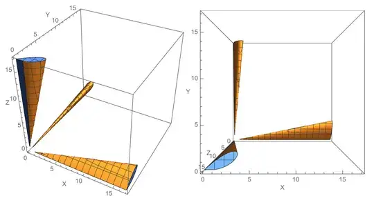

Surface that separates $x_1 > x_3$ and $x_1 < x_3$
The region where $x_1 \geq x_3$ is the 3 disconnected "branches" enclosed inside the yellow surfaces in the figure below. That is, we have $x_3$ being the largest in most of the space.
The blue surfaces are "fake" and are merely there to show the cutoff at the box (plotting range). In the plot the axes $X$, $Y$, and $Z$ stands for $a$, $b$ and $c$, respectively.
The right figure is the top view staring straight down into the branch where $c > a > b$. Note that there are a total of six orders for the three things $(a,b,c)$, but the boundary of $x_1 = x_3$ for this branch doesn't go into $c > b > a$ and is completely inside $c > a > b$.
That is, despite $x_1$ and $x_3$ individually being symmetric in all six permutations of $(a,b,c)$, there are only three branches and not six. The three branches are cyclic: they are 3-fold-rotationally invariant ($a \mapsto b,\, b \mapsto c,\, c \mapsto a$) but not swapping invariant ($ a \leftrightarrow b$).
Also note that the surface is "intercepted" at $b = 0$ (the $X$-$Z$ plane at $Y = 0$).
The fact that the three branches are disconnected (except at $(0,0,0)$ the origin) means one can consider the boundary surface $x_1 = x_3$ separately for each branch.
Again, take the $Z$-branch in $c > a > b$ in the right figure ($Z > X > Y$) for example. The surface $x_1 = x_3$ as the implicit function is $$\frac{a}{b} + \frac{b}{c} + \frac{c}{a} = 2 \left( \frac{a}{b + c} + \frac{b}{a + c} + \frac{c}{a + b} \right) \tag*{Eq.(2)} \label{Eq_02}$$ Despite the pretty functional form with nice symmetry, to solve for the explicit $c = f(a,b)$, namely, $z = f(x,y)$, is to solve the roots of a quartic polynomial (4-th power in $z$).
Quartic equations indeed permits analytic solutions in general (the roots can be expressed in radicals). Unfortunately, the surface of each branch consists of two pieces with a critical (split) point that allows no analytic expression. Namely, for the $Z$-branch, given a position $(x,y)$ one can obtain the height $z$ (the corresponding point on the surface) only after numerically testing which piece this point belongs to via checking $x \gtrless x_0$, where $x_0$ is a root of a $16$-th degree equation. (the degree of $16 = \text{4-by-4}$ is not a coincidence)
The implicit function \ref{Eq_02} of three variables can be rewritten into (another implicit function) $$\cot\phi + \frac{t}{ \cos\phi } + \frac{ \sin\phi }{ t } = 2\left( \frac{ \sin\phi }{ t + \cos\phi } + \frac{ \cos\phi }{ t + \sin\phi } + \frac{ t }{ \cos\phi + \cos\phi } \right) \tag*{Eq.(3)} \label{Eq_03}$$ where $\phi \equiv \arctan( \dfrac{x}{y} )$ is the azimuthal angle and $t \equiv \dfrac{z}{ \sqrt{x^2 + y^2} }$ is the cylindrical tangent.
There are many other re-parametrizations that either make the equation more compact (involving only 1 variable) or more geometric (invoking $x>y \Longleftrightarrow 0< \phi < \pi/4$ and introduce more trigs). As far as I can tell, none of them alters the fact that the surface is quartic in nature. As a whole, \ref{Eq_03} has a better balance among the many equivalent expressions.
