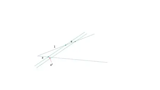

Use this construction. BTW, it can also be used to multiply $a$ times $b$:
The green lines are parallel. The blue lines are any two that form an angle. You need a unit length as well, of course.

1But then this construction requires two line segments: one of length $;a;$ , the other one of length $;1;$ ... – DonAntonio May 13 '18 at 17:22
Also: see silverfish's comment on the question here (https://math.stackexchange.com/questions/705/compass-and-straightedge-construction-of-the-square-root-of-a-given-line) to see why a unit length is necessary for the question even to make sense. (Also Isaac's answer to the same question.) – John Hughes May 13 '18 at 19:23
