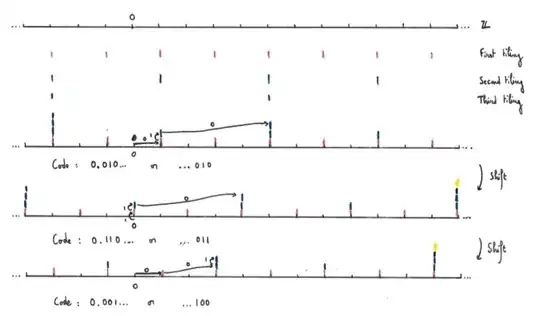

What does this has to do with tilings? Well, let's consider tilings on $\mathbb{Z}$. There are only two tilings of $\mathbb{Z}$ with tiles of length $2$: the one with endpoints on even integers, and the one with endpoints on odd integers.
There are four tilings of $\mathbb{Z}$ with tiles of length $4$. However, if we are given a tiling by tiles of length $2$, only two of them are compatible. For instance, if we are given the even tiling of length $2$, then the compatible tilings of length $4$ are those whose endpoints are $0[4]$, or those whose endpoints are $2[4]$.
It's the same with tilings of length $8$: there are eight of them, but only two of them are compatible with any tiling of length $4$.
Let $X$ be the set of sequences of tilings $(T_2, T_4, T_8, \ldots)$, where $T_{2^n}$ is a tiling by tiles of length $2^n$, and they are all compatible. Then, when refining the tiling, we have two choices at each step, so this set can be easily made in bijection with $\{0,1\}^{\mathbb{N}}$.
For a specific bijection, for $n \geq 1$, let $u_n$ be the smallest nonnegative value of an endpoint of a tile of length $2^n$, put $u_0 := 0$, and let:
$$x_n = \left\{ \begin{array}{lll} 1 & \text{ if } & u_n = u_{n-1} \\ 0 & \text{ if } & u_n > u_{n-1} \end{array}\right.,$$
Then take $x := \ldots x_3 x_2 x_1 \in \mathbb{Z}_2$. For instance, $x = \ldots 010$ means that the $2$-tiles end on odd values, the $4$-tiles on $1[4]$ values, and the $8$-tiles on $5[8]$ values.
This yields a bijection $\varphi : X \to \mathbb{Z}_2$. The nice thing is that its conjugates the translation by $+1$ on $\mathbb{Z}$ (or rather, the translation $\widetilde{T}$ of $-1$ of the tilings) with $T$:
$$\varphi \circ \widetilde{T} = T \circ \varphi.$$
This gives you a geometric interpretation of the odometer as sequences of tilings. As a corollary, $X$ carries a unique translation-invariant probability measure.
Here is an example of tiling, its coding and the effect of the shift:
