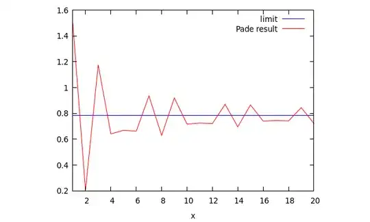

If you look at $\lim_{t\to\infty} [x/x]_{A^2}(t)$, the first 20 results look like this:
