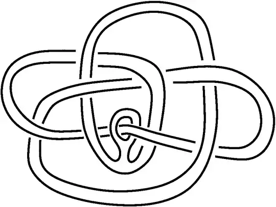

For example, there are things called non-invertible knots:
http://en.wikipedia.org/wiki/Invertible_knot
So how do we cook up a knotted pair-of-pants from that?
Here's the idea. The non-invertible knot in the link above is sometimes called $8_{17}$. Here is another picture of it:
http://katlas.org/wiki/8_17
Here is a variant on that.
Interpret this image as a ribbon of paper that has three boundary circles. One boundary circle is unknotted. One is $8_{17}$. The other is some other knot.
It turns out that other knot isn't trivial, nor is it $8_{17}$.
So why can't this knotted pair of pants be turned inside-out? Well, the three knots are distinct, and $8_{17}$ can't be reversed.
The reason why I know the other knot isn't $8_{17}$? It's a hyperbolic knot and it has a different ($4.40083...$) hyperbolic volume than $8_{17}$ ($10.9859...$).

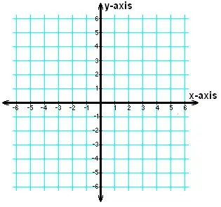

Take a look at the Wikipedia page for diffeomorphism. In particular,the lead image
When I look at that image I see the standard Cartesian coordinate grid, but deformed a little.

Now you intuitively see that a rubber sphere with punctures can be turned inside out by continuous motion, whereas a perfect sphere cannot.
To understand why, let's concentrate on 2-dimentional plane, taking a circle instead of a sphere. It can be proven that any continuous deformation that inverts the circle will make it cross itself. However if the circle has 'holes', or gaps, then it topologically is equivalent to one or more line segments, which can all be inverted in place without touching each other (appropriate scaling may be necessary).
Similar feature holds for a sphere too. Hence you cannot turn a shirt inside out if all the holes are sealed, but you can do it even if you have one hole (and provided that the shirt is flexible enough to go through that hole if the hole is small).
