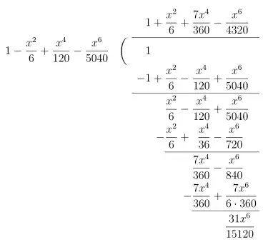

Note the most direct way to obtain the expansion of $\dfrac1{\sin z}$ is division by increasing powers. I'll show how to obtain the first four terms:
Start from the expansion of $\sin z$ at order $7$:$$\frac1{\sin z}=\frac1{z-\dfrac{z^3}{6}+\dfrac{z^5}{120}-\dfrac{z^7}{5040}+o(z^7)}=\frac1z\cdot\frac1{1-\dfrac{z^2}{6}+\dfrac{z^4}{120}-\dfrac{z^6}{5040}+o(z^6)}$$ Now the division of $1$ by $1-\dfrac{z^2}{6}+\dfrac{z^4}{120}-\dfrac{z^6}{5040}$ goes as follows (we truncate the terms with degree more than $6$) :
Thus we obtain \begin{align} \frac1{\sin z} &= \frac1z \Bigl( 1 + \dfrac{z^2}{6} + \frac{7z^4}{360}- \frac{z^6}{4320} +o(z^6)\Bigr) \\[1ex] &=\frac1z + \dfrac{z}{6} + \frac{7z^3}{360}- \frac{z^5}{4320} +o(z^5) \end{align}
