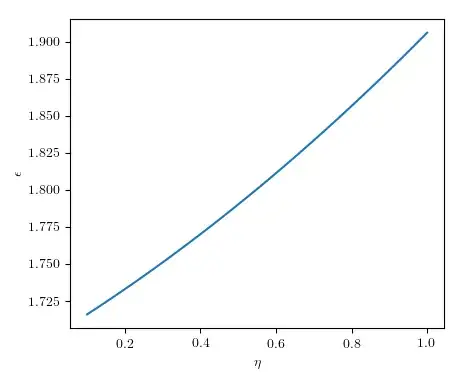

This a small script to calculate the average energy given a value of $\eta$
import mpmath
import scipy.optimize
# fermi-dirac integral
def fdint(s, eta):
    result = -mpmath.gamma(s + 1) * mpmath.polylog(s + 1, -np.exp(eta))
    return float('{}'.format(result.real))
# average energy from eta
def avge_eta(eta):
    return fdint(1.5, eta) / fdint(0.5, eta)
If you want to calculate $\eta$ (equivalently $T$) for a given value of $\epsilon$, add this function
# eta from average energy
def eta_avge(e):
    f = lambda x: avge_eta(x) - e
    results = scipy.optimize.newton(f, 1.0)
    return np.real(results)

  • I'm a little confused though as I expected the energy to increase with eta. If i got it right, the ratio of the fermi-integrals can be expressed as 1.5*polylog(5/2,-exp(x))/polylog(3/2,-exp(x)) which gives the following plot: http://www.wolframalpha.com/input/?i=plot+polylog(5%2F2,-exp(x))%2Fpolylog(3%2F2,-exp(x)) – OD IUM Apr 19 '18 at 11:52
  • @ODIUM You're right, there's a problem with the Wiki entry I cited: a minus sign. Sorry, I didn't double check that before posting my answer – caverac Apr 19 '18 at 12:13
