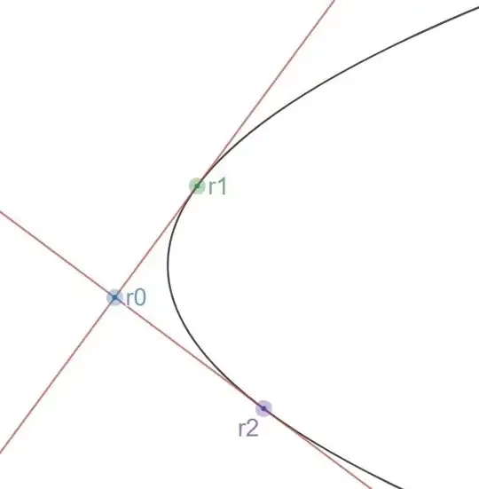

Let $$\textbf M=\begin{bmatrix}a & h & g \\ h & b & f \\ g & f & c\end{bmatrix} \qquad \textbf r=\begin{bmatrix}x \\ y \\ 1\end{bmatrix}\qquad \textbf{r}_k=\begin{bmatrix}x_k \\ y_k \\ 1\end{bmatrix}\qquad \mathrm d\textbf{r}=\begin{bmatrix}\mathrm dx \\ \mathrm dy \\ 0\end{bmatrix}$$ Then equation of conic is $\mathrm S \equiv\textbf{r}^{\mathrm T}\textbf{Mr}=0$
  • Firstly, $\ \vec{\textbf a}^{\ \mathrm T}\textbf{M}\vec{\textbf b}=\vec{\textbf b}^{\ \mathrm T}\textbf{M}\vec{\textbf a}$
  • Next, $\mathrm {dS}=2\textbf{r}^{\mathrm T}\textbf{M}\mathrm d\textbf r$
  • Equation of tangent at $\textbf r_1$ is $\textbf{r}_1^{\mathrm T}\textbf{M}\textbf r=0$
  • Equation of Chord of contact from $\textbf r_0$ is $\textbf{r}_0^{\mathrm T}\textbf{M}\textbf r=0$
My attempts for proving $\mathrm{T^2=SS_0}$ is the pair of tangents.
  • The pair of tangents is $(\textbf{r}_1^{\mathrm T}\textbf{M}\textbf r)(\textbf{r}_2^{\mathrm T}\textbf{M}\textbf r)=0$
    • Sub Goal: to find a relation among $\textbf{r}_0$,$\textbf{r}_1$ and $\textbf{r}_2$
  • The equation $(\textbf{r}_0^{\mathrm T}\textbf{M}\textbf r)^2-(\textbf{r}^{\mathrm T}\textbf{Mr})(\textbf{r}_0^{\mathrm T}\textbf{M}\textbf{r}_0)$ passes through $\textbf{r}_0$,$\textbf{r}_1$ and $\textbf{r}_2$. Thus if it is a degenerate hyperbola, then we are done.
    • Sub Goal: $\det(\textbf{M}\textbf{r}_0\textbf{r}_0^{\mathrm T}\textbf{M}-(\textbf{r}_0^{\mathrm T}\textbf{M}\textbf{r}_0)\textbf{M})=0$
  • Assuming pair of tangents can be written as $\mathrm{T^2-\lambda S - \mu T}=0$. Now equating slopes at 1 and 2 reveals $\mu =0$ and and since it passes through 0, we get $\lambda=\mathrm S_0$
    • Sub Goal: proving the assumption.

To show that the matrix $\mathbf M\mathbf r_0\mathbf r_0^T\mathbf M-(\mathbf r_0^T\mathbf M\mathbf r_0)\mathbf M$ is singular it suffices to show that it has a nontrivial null space. The null space of a line consists of the points on the line, so the null space of a pair of lines consists of the points on both lines. We therefore expect that $\mathbf r_0$ is a null vector of the matrix, and indeed $$\begin{align} [\mathbf M\mathbf r_0\mathbf r_0^T\mathbf M-(\mathbf r_0^T\mathbf M\mathbf r_0)\mathbf M]\mathbf r_0 &= \mathbf M\mathbf r_0\mathbf r_0^T\mathbf M\mathbf r_0-(\mathbf r_0^T\mathbf M\mathbf r_0)\mathbf M\mathbf r_0 \\ &= (\mathbf r_0^T\mathbf M\mathbf r_0)\mathbf M\mathbf r_0-(\mathbf r_0^T\mathbf M\mathbf r_0)\mathbf M\mathbf r_0 \\ &= 0\end{align}.$$
This particular formulation of the tangent cone is related to the tangent-secant theorem. As well, it generalizes to higher dimensions: the tangent cone to a quadric $Q$ with vertex at $\mathbf v$ is $(Q\mathbf v)(Q\mathbf v)^T-(\mathbf v^TQ\mathbf v)Q$. (There’s another, and I think more straightforward, construction of the tangent cone in the plane, but it doesn’t generalize in the way this one does.)
This expression looks a lot like an application of Plücker’s mu to me, and sure enough it can be derived using that method. $\mathbf M\mathbf r_0$ is the polar line of $\mathbf r_0$, and so the degenerate conic $(\mathbf M\mathbf r_0)(\mathbf M\mathbf r_0)^T = \mathbf M\mathbf r_0\mathbf r_0^T\mathbf M$ is a double line that passes through the intersection points of of the conic $\mathbf M$ and the tangents through $\mathbf r_0$. Applying Plücker’s mu, a conic that shares these intersection points and also passes through $\mathbf r_0$ is $$\begin{align} (\mathbf r_0^T\mathbf M\mathbf r_0)(\mathbf M\mathbf r_0)(\mathbf M\mathbf r_0)^T-\mathbf r_0^T(\mathbf M\mathbf r_0)(\mathbf M\mathbf r_0)^T\mathbf r_0\mathbf M &= (\mathbf r_0^T\mathbf M\mathbf r_0)[(\mathbf M\mathbf r_0)(\mathbf M\mathbf r_0)^T - (\mathbf M\mathbf r_0)^T\mathbf r_0\mathbf M] \\ &= (\mathbf r_0^T\mathbf M\mathbf r_0)[(\mathbf M\mathbf r_0)(\mathbf M\mathbf r_0)^T - (\mathbf r_0^T\mathbf M\mathbf r_0)\mathbf M]. \end{align}$$ If $\mathbf r_0$ does not lie on the conic, we can drop the factor of $\mathbf r_0^T\mathbf M\mathbf r_0$ and have the required expression. If on the other hand $\mathbf r_0$ lies on $\mathbf M$, the tangent at that point is its polar line so we have the double line $(\mathbf M\mathbf r_0)(\mathbf M\mathbf r_0)^T$ from which we can freely subtract the term $(\mathbf r_0^T\mathbf M\mathbf r_0)\mathbf M$ since in this case $\mathbf r_0^T\mathbf M\mathbf r_0=0$.
