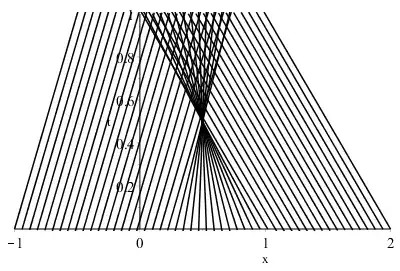

Let us introduce the function $f : x\mapsto u(x,0)$. A good start with such initial-value problems for transport (hyperbolic) equations is to draw the characteristic curves in the $x$-$t$ plane, obtained through the method of characteristics. These curves have equation $x(t) = (1-2f(x_0))\, t + x_0$:
characteristics
The breaking time $t_b$ when such curves intersect corresponds to the generation of a shock wave: $$ t_b = \frac{-1}{\min \partial_x\left(1-2f(x)\right)} = \frac{1}{2} \, . $$ Until characteristics intersect $t<t_b$, the solution is given by the method of characteristics. It can be obtained by solving $u = f(x - (1-2u)t)$: $$ u(x,t) = \left\lbrace \begin{aligned} &1/4 &&\textstyle\text{if}\quad x < \frac{1}{4} + \frac{1}{2}t\\ &(t-x)/(2t-1) &&\textstyle\text{if}\quad \frac{1}{4} + \frac{1}{2}t < x < 1 - t\\ & 1 &&\textstyle\text{if}\quad 1 - t < x \end{aligned}\right. $$ One can observe that the characteristics cross at the time $t_b$ and the abscissa $x_b = 1/2$. After the formation of the shock, the shock speed is given by the Rankine-Hugoniot condition $$ s = \frac{1(1-1) - \frac{1}{4}(1-\frac{1}{4})}{1 - \frac{1}{4}} = -\frac{1}{4} \, . $$ The solution for $t>t_b$ is therefore $$ u(x,t) = \left\lbrace \begin{aligned} &1/4 &&\textstyle\text{if}\quad x < \frac{1}{2} - \frac{1}{4}t\\ &1 &&\textstyle\text{if}\quad \frac{1}{2} - \frac{1}{4}t < x \end{aligned}\right. $$
